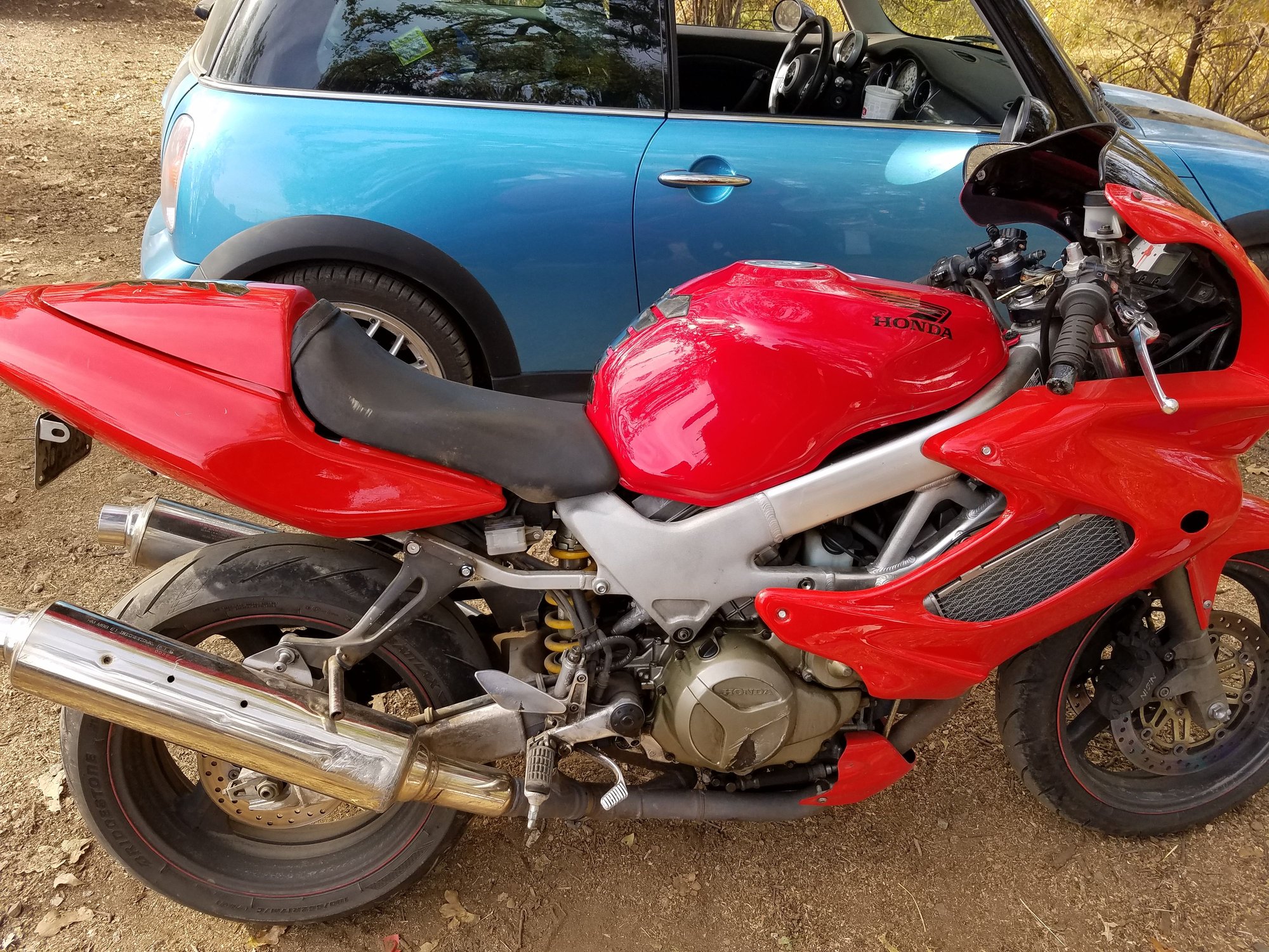

My baby

Looks like it's been in a fight or two
You can get Carbonadi carbon fibre engine covers that will hide the previous damage and offer protection if it goes down again on the tarmac. And you might want to think about upgrading to manual cam chain tensioners.
Carbonadi - clutch protector VTR1000 Firestorm clutch protector HONDA VTR1000 Firestorm
