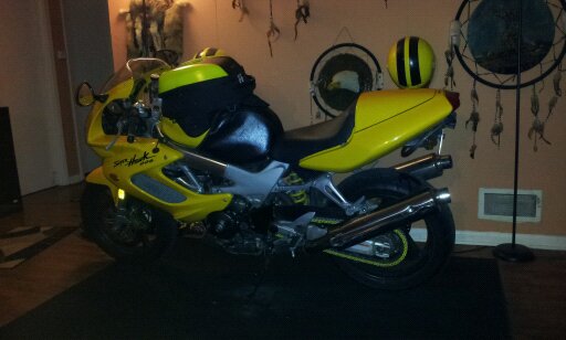

well got my bike back today and wow what a difference, didn't realize how much it was losing due to bad bearings and also found chain was bad had tight spots and loose spots in it...bought a really nice chain (gold) 530 and new bearings and seals in rear wheel and dampners set , she rides so smooth now and a steady grab not speratic like and even seems to be smoother shifting . Had them look at my sprockets and they were in good condition. unbelievable how much difference it makes..Oh and this chain was listed at $175. but my mechanic got it for me at $100. forget brand but was (according to him top line chain ). I know pics are important lol !!!
