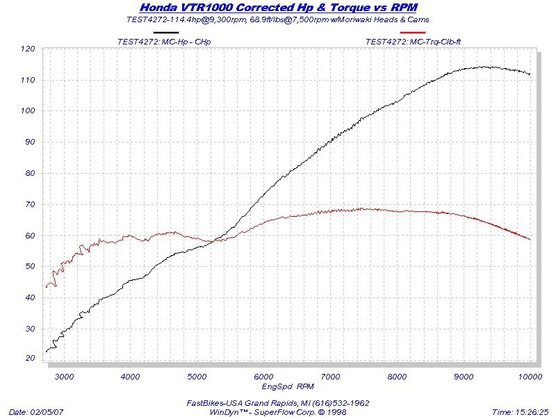

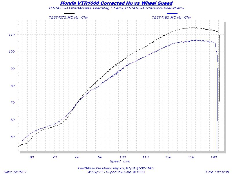

It was the full stage 1 recipe, with a full exhaust system. Should have been ~120 HP. I never made the time to test it. The dyno was a couple hours away, and the wife hates everything motorcycle.
AZZKIKER bought my heads, cams and flywheel. He got 114 HP and 79 ft-lbs, with stock bottom end and 2 Bros slip-ons. I had the 2 bros and when I went to the full Moriwaki, the seat of the pants difference was large and obvious. He posted the dyno results here a while back.
The engine had the same torque/power delivery characteristics, but more everywhere.
Old Feb 8, 2008 | 04:39 AM
AZZKIKER's Avatar
Joined: Aug 2004
Posts: 731
From: MICHIGAN
AZZKIKER is an unknown quantity at this point
actually it made 114.4 HP and 69ft-lbs of torque and I had a FULL 2 bros exhaust on it.

Old Feb 8, 2008 | 04:41 AM
AZZKIKER's Avatar
Joined: Aug 2004
Posts: 731
From: MICHIGAN
Old Feb 8, 2008 | 04:42 AM
AZZKIKER's Avatar
Joined: Aug 2004
Posts: 731
From: MICHIGAN
the last graph is before and after the new heads.
