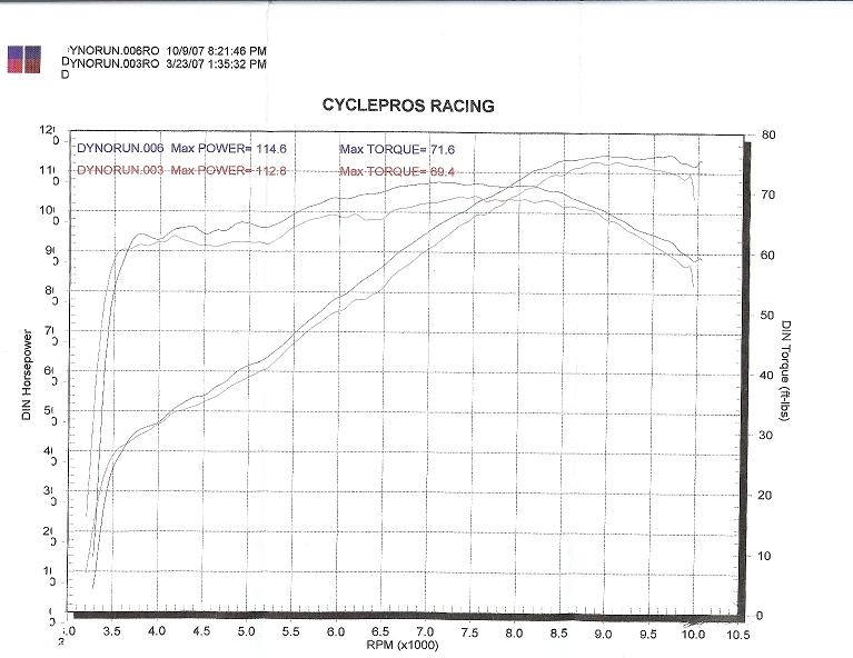

My engine have hi comp JE pistons, ported and finished intake and exhaust, finished and polished combustion chambers, balanced conrods and crankshaft, BMC race filter, Dynojet kit (US spec), two short trumpets on both carbs and GPR street legal slipons (with db killer) and stock headers.
You can see my dyno chart on the forum gallery.
Bye

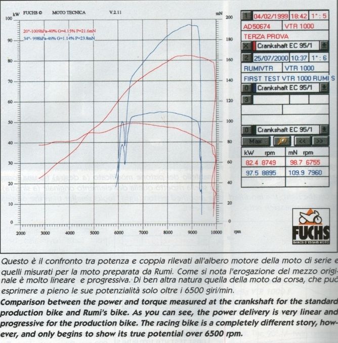

Originally Posted by Kitch
Best I've seen is 140bhp from the RUMI built race bike.
Rumi Superbike VTR specs: 140bhp, 163Kg, Moriwaki and Robby Moto Engineering parts, WP suspension front and rear, Arrow pipe, Marvic Penta Magnesium wheels, reinforced rear swingarm, 520 chain, CF airbox, Brembo brake parts, engine heavily modified.
This is the dyno chart of this RUMI VTR.
It was dynoed by italian magazine SuperMotoTecnica in june 2001

Just reading this thread. With mods very similar to what Azzkicker posted and what RCVTR had done before, I got very similar numbers. I did not mill the heads but used HiComp pistons, stage 1 cams and cleaned up the intake ports. The lower curve was the mods with slipons, the upper curves were after full exhaust and some hrc tuning parts. It all started stock at about 100hp.
15% on a bike making 100hp is a VERY noticeable difference and really changes the character of the bike, but keeps it completely rideable in all conditions. It is expensive per hp, but as has been said here, most of us do it because we love working on them, get obsessed chasing improvements or want to keep learning something about how they tick. bang for buck, I think the suspension mods are best yield, but the added power sure makes it a blast to ride.
bill

Riccardo, that number seems a bit hight compared to others I've seen. I'm not saying you haven't done an excellent job (or whomever did the work). I'm sure you/they have. It's just that there are a lot of variables in dyno testing, and my info comes from a known (to me) source.
You have lighened the crank and flywheel, which changes the inertial mass of the engine. Lighter wheels, chain etc. will also effect drivetrain inertia. Was any calibration done to account for this? And how long was the sweep time? The most accurate measurement occurs in the absence of acceleration. Although by the seat of the pants, lower inertia = more power
I'm not really trying to argue, so much as learn more about testing.
I don't know what to say!!!
I've dynoed my bike 3 times on the same dyno at sea level.
First time, in 2004, I read 105,9 hp at 8700 rpm whit stock exhaust, BMC race filter and Dynojet kit (European Spec).
I think that this value is reliable compared to the Stock VTR's dyno runs I've seen. They are all between 103 and 105 Hp, both the ones done by Dynojet and those done on the Dyno I used.
Two years later, in 2006 with the big engine work done, I read 117 hp at 9000 rpm, but there was an electrical problem on the rear cylinder that caused a slight misfiring.
Next year, with electrical problem solved, I've done my "ultimate" dyno run reading 119 hp at 9000.
The only inertial change I've done is a 520 chain kit in 2007.
Probably I've been very lucky doing my porting-finishing-polishing-grinding job!
That's all I can say.

Riccardo. I was looking for your torque/RPM curve and could not locate it. I was interested in the mirange torque characteristics/comparison.
thank you.
thank you.
https://www.superhawkforum.com/galle...ry.php/cat/501

I didn't realize it was the same bike.
I'm not sure what to think.
It doesn't have remotely similar torque characteristics.
