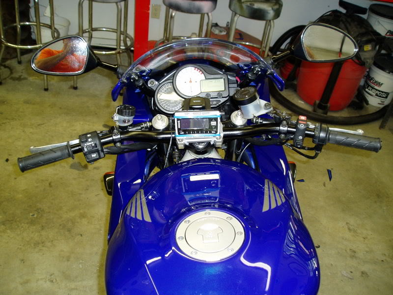

Old Nov 21, 2007 | 05:31 PM
superbling's Avatar
Posts: 2,553
From: South Texas
Teaser to get you to search:

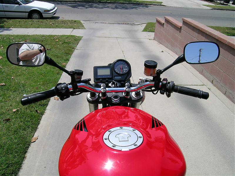

Old Nov 21, 2007 | 06:12 PM
Yardstick's Avatar
Joined: Mar 2006
Posts: 176
From: Chandler, AZ
Yardstick
And another...

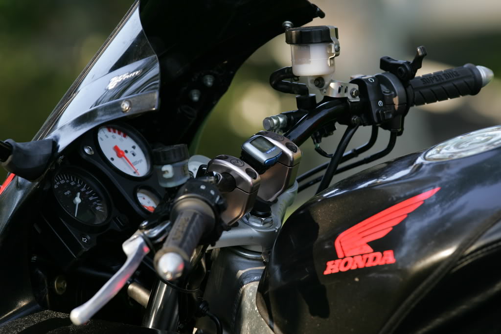

Old Dec 3, 2007 | 08:06 AM
kai ju's Avatar
Joined: Jun 2005
Posts: 524
and one more........
