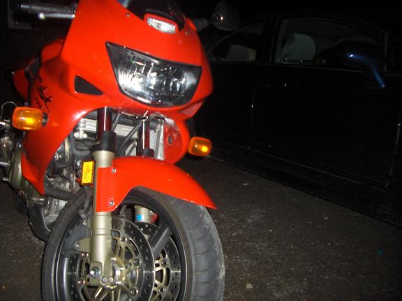

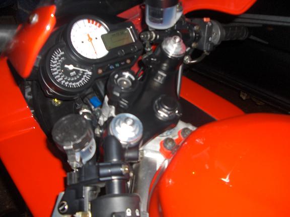

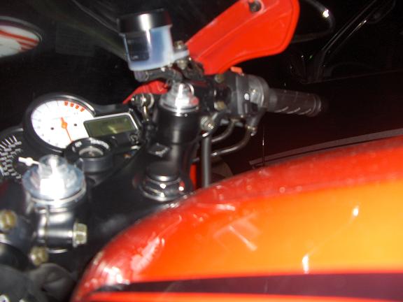

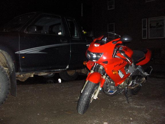

I attached some pics i took in the dark just now. shitty quallity. Does it look stock? I got the first owner's email from the second owner a few minutes ago so I'll see what I can dig up pending SH forum member analysis.
ps. mighty toyota in the background is my other toy

These are the stockers, but you could have springs in there
