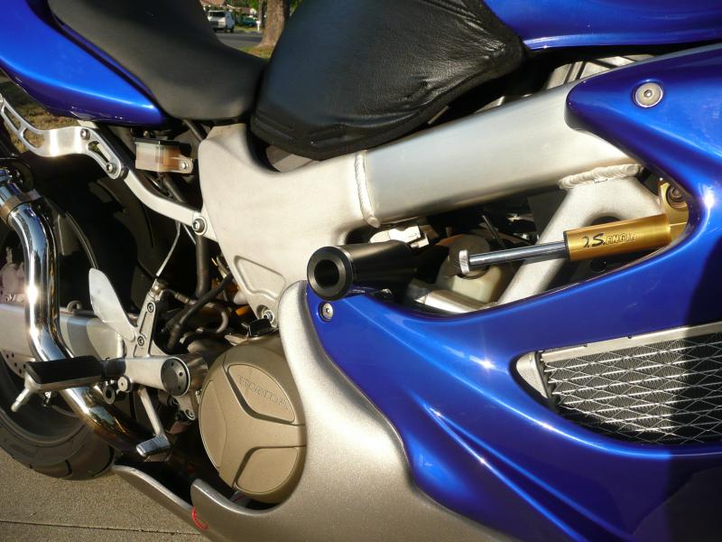

I don't know who this is made by but, I like what it makes me do more of......
It makes me really lean more to turn the bike. This has taken great pressure off my forearms and increased saddle time.
I traded for this piece not really confident it was for a hawk. Regardless I was never going to need the piece I traded away.
My mechanic says the sticker is from RC car racing and has zero to do with manufacturing identification. I haven't done a considerable amount of looking into it. I would like some information if someone knows something?.
Attached Thumbnails Steering Damper ????-london-030.jpg   Steering Damper ????-london-031.jpg   Steering Damper ????-london-032.jpg

interesting. at speed i think that we fight the 'tuned chassis' and find fixes to get things a bit more rigid. with the damper on tighter settings you should feel confident that the tire will track and be able to do what you should... be light on the bars, but this comes at a price... when you do want to turn the bike it takes greater force. in my case i get a bigger workout with the damper, but i run it pretty tight as our track has more higher speed corners than tight technical ones.

Has anyone got any detailed photos of how to mount one, I have a universal damper but no fitting kit, I can't imagine it being too difficult to fabricate one.

In the photos I can see the fork clamp easily but I can't see how you have mounted it to the frame clearly, did you drill into the frame..?
