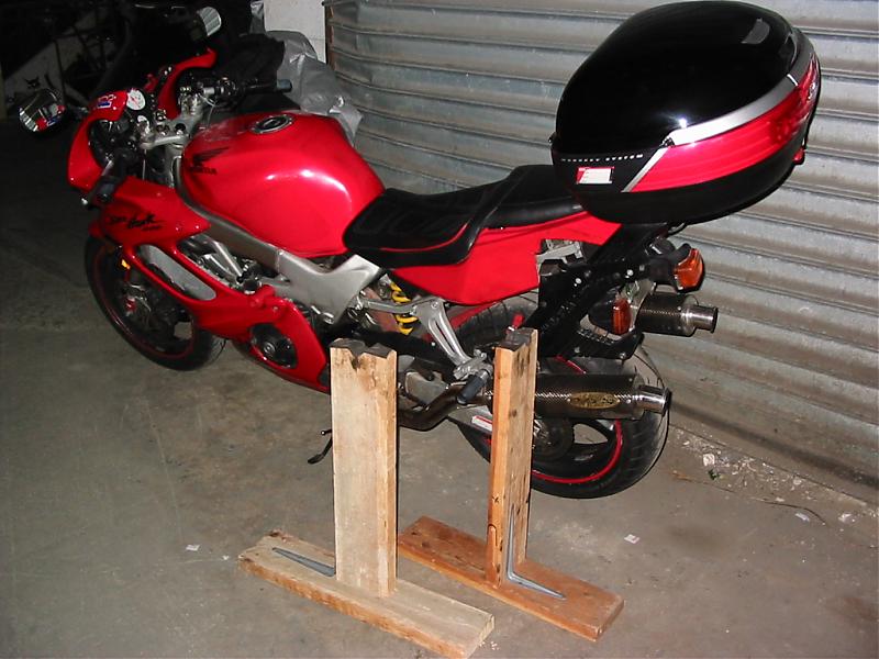

Old Aug 3, 2008 | 10:20 PM
  #35
I know this is an old thread but It really saved me alot of work when my shock failed. I made these stands from basement wood in a matter of minutes and the job was a snap.
Old Aug 3, 2008 | 10:22 PM
  #36
Oh yeah. they hold a barbell bar that goes through in front of the passenger pegs; very stable. They are purposefully made at a 90 degree angle to each other for 2 dimensional stability
