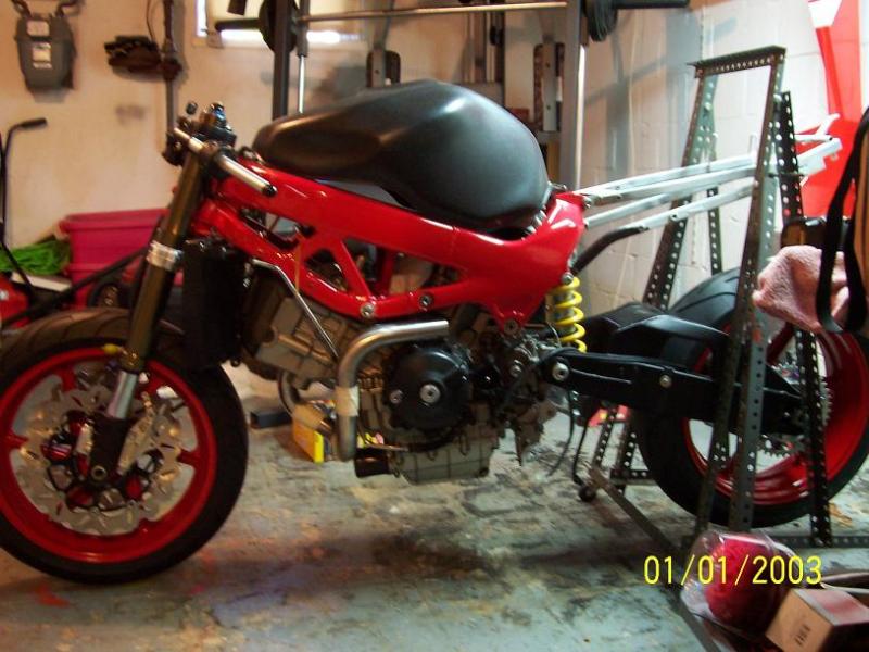

here is a sexy arm
Attached Thumbnails Sexy swingarms-101_4805.jpg   Sexy swingarms-picture-018.jpg

here is a sexy arm
? nothing new there seen that done loads times, tweety's looks better imo

really? attitude?
i am aware of tweety's bike ,yes it is nice.
i was showing you another option.
attitude not needed.
eta.....mine is not bad at all.

i am right in thinking that is an RC swing arm?
Old Sep 1, 2012 | 01:12 PM
hawxter996's Avatar
ole dirty bastard
Posts: 976
From: my house
yes sir,it is.
looks a lot like the 954 arm,with the added benefit of being easier to attach.
