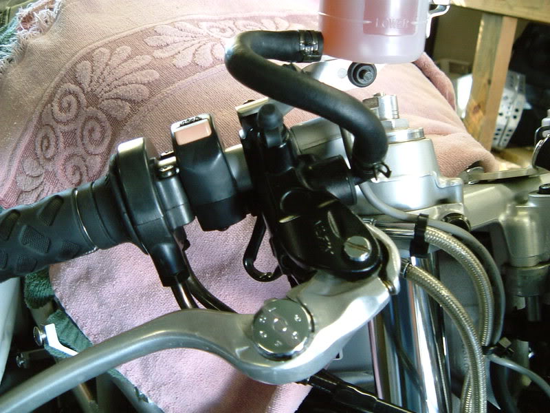

So looking at the site, it looks somewhat less than Kosher in terms of construction but once you have it in your hands its really not bad at all.
It appears that the body is made out of milled aluminum and is marginally lighter than stock M/C. The paint on it is not quite up to par but as I spill brake fluid all over everything, I wasn't that concerned.
I was, however, concerned about both the reserve bottle they send attached on it, and the rubber inside and it's resistance to brake fluid. I took the seals out and soaked them in dot.5 for 3 days and there was zero change in size, a good sign.

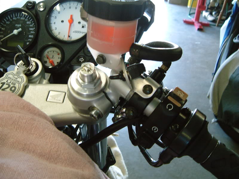

Mounting the unit was somewhat difficult as out stock cup (which I was going to fit to the unit with some finagaling) and the cup that comes on it will not clear the fairing. My solution is in all of the pictures and the bracket only requires a small amount of bending, I used a bench clamp anvil and a hammer, apparent by the kind of poopy appearance of the bracket.
It did also require moving the right side controls to the left a bit because the lever did not cover the handles appropriately. It was as simple as cutting off the locating pin on the inside of the controls and scooching it over a little bit.
So all in all, it bolted up with about an hour of fussing (including bleeding system).

On a side note, the lever is easily adjusted and even at the minimum setting, it is difficult to get the lever to touch the bar. And as well, this unit DOES NOT HAVE A BRAKE SWITCH and as well, required a small amount of brake line between the cup and the intake on the cylinder because the orientation is further away.
I believe it is meant for track bikes (similar to the Brembo race line) and does not have anywhere to mount a switch. However, I am going to be putting a nice shiny pressure switch on the Banjo and then I'll have a front brake switch but the only times when I need someone to know that I am slowing down is when I'm on the streets and I always use my rear brake as my front suspension is not so kind with bumps under hard braking.

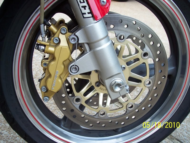

Looks nice, you will like the Radial MC for sure i went a different option several years back when i converted to 00/01 GSXR 6 pot calipers and MC.
