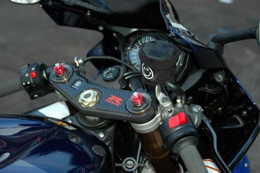

What I don't get is that unlike the SH master cyl. the GSXR m/c has no hole to mount the res. to. From what I can find online it appears that the GSXR clip-on has a threaded hole in it for the res to mount to, instead of it mounting directly to the m/c. I was asking about the 5/8 just because I thought the 1000 m/c was 3/4" (19mm.) bore. I've attached a pic. of a newer gixxer w/ a radial m/c but it appears to mount the same (to the bar).

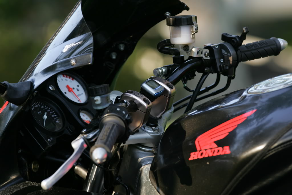

Mount it to the upper perch bolt (8mm head), hence the "turn the bracket around/upside down" comment.

Nice lookin' bar risers...SuperBling..and is that a nice looking clock in the middle I see? Yum yum...brands? links?
Happens every time I post this pic........ hee-hee Like moths to a flame!
Bar risers are from Moose racing, check any bona-fide dirt bike vendor. I'm using TAG's now which are usually cheaper. Do a net search.
Clock in the middle is a clock, sort of. It's a Sigma BC800 bicycle computer; WAY, way, more accurate than the stock speedo plus it gives you an extra tripometer, highest speed, total time, and as you surmised a clock. When set up right, it's as accurate on speed as a GPS since it doesn't rely on the gearing like the stocker but rather front wheel speed.
