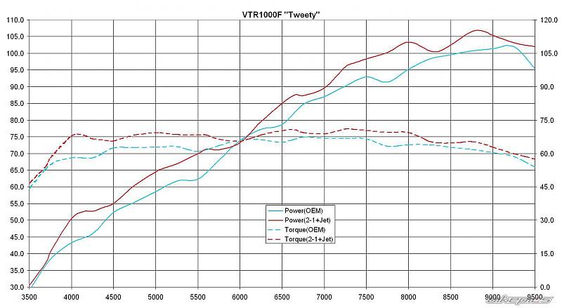

I completed my 2-1 exhaust conversion yesterday. I had picked up a Blue Flame dual port high-mount can for a 98 R1 on eBay and, after some cutting and praying, managed to fit the link pipe so as to mount it up to my Micron support. I cut the headers at the joint of the two pipes and cleaned out the welds with the dremel before re-wrapping the pipes. Incidentally, I found the dyno chat below from a chap who also did a 2-1 conversion. I am looking forward to firing it up to see how it runs.

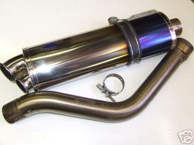

Hi again gents,
I basically just chopped off the header just after the collector (just before it splits again). Fortunately, the short section of pipe there is 2" in diameter or the same as the R1 link pipe. Looking at the pic of the can and pipe below, I fastened the end of the link pipe located in the lower left to the header then cut it at swingarm level. I then attached it to the part that has been cut with a joiner (2" i.d. to 2" i.d.) whoich allowed me to rotate the pipe clockwise slightly and cut off the last four inches of the pipe (with the larger diameter). The position is virtually identical to that of the former Micron pipe. Total cost: $5.49 for the link pipe and three exhaust clamps ($13). One final thing, the blue of the pipe matches the bike so it looks sweet. Can't wait to lace up the PVM's....
BTW, I spent a few hours cleaning up the header (cutting it gives good access to what is the most restrictive and sloppiest part of the assembly) so that alone should do wonders to improve the air flow.
