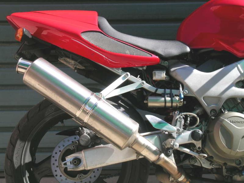

When I mounted the RC51 mufflers I had to give up passenger pegs because the stock mounts just didn't fit the higher mounted mufflers.

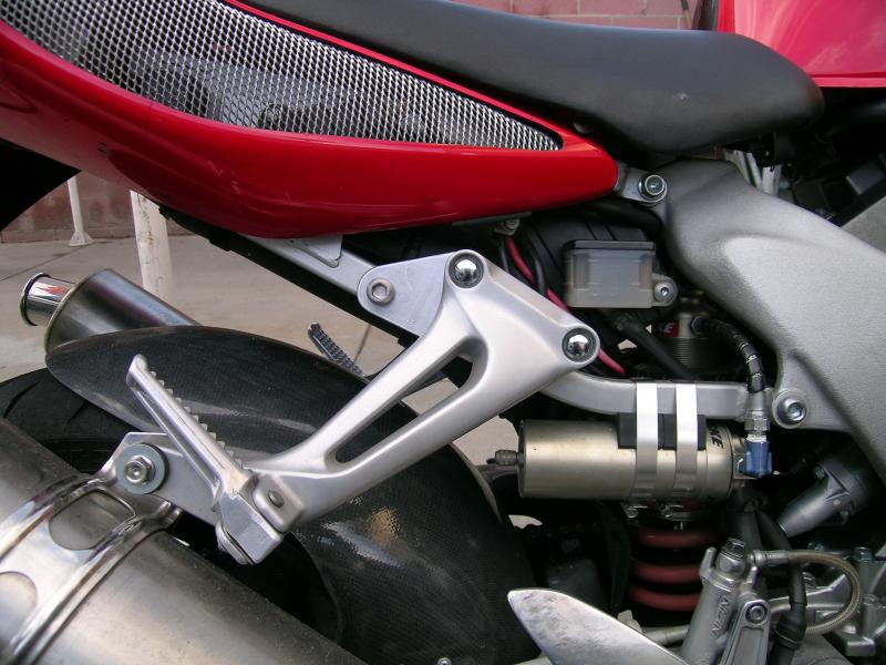

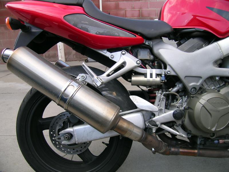

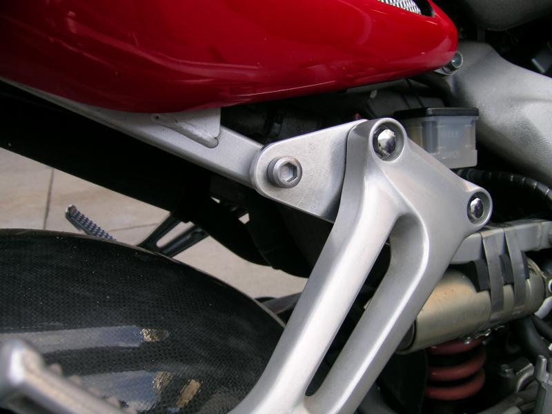

So while looking through the German forum a month or so ago I found a pic of a VTR with the stock mounts relocated on the subframe.

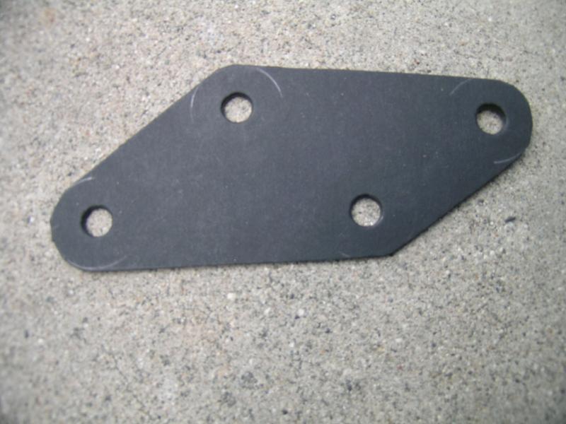

Looked like a great idea, so I made some cardboard templates, followed by the real thing made from 1/4" aluminum plate.
I know I should have taken a pic of just the plate installed and if anybody wants to see it I'll do that tomorrow.
The first pic is the old mount.

That is awesome, I see exactly what you did there and I'm going to have to do it soon as well. I have some passenger pegs with the stock exhaust mounting bracket that is way too low for my high-mount Two Bros. and my wife can't wait to ride with me so I need to get those pegs on soon or else she'll be wanting to go out and buy her 250 ninja like now.
I don't know though, I think my high-mounts are mounted higher than the ones in your pictures, it's still an excellent concept though; I'll see if I can make it work. Thanks for the post.

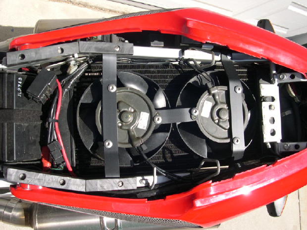

Cool idea, whats up with the cutout on the tail? Rear radiator?
Old Feb 8, 2009 | 08:47 AM
kai ju's Avatar
Joined: Jun 2005
Posts: 524
Yes,
Kai Ju
