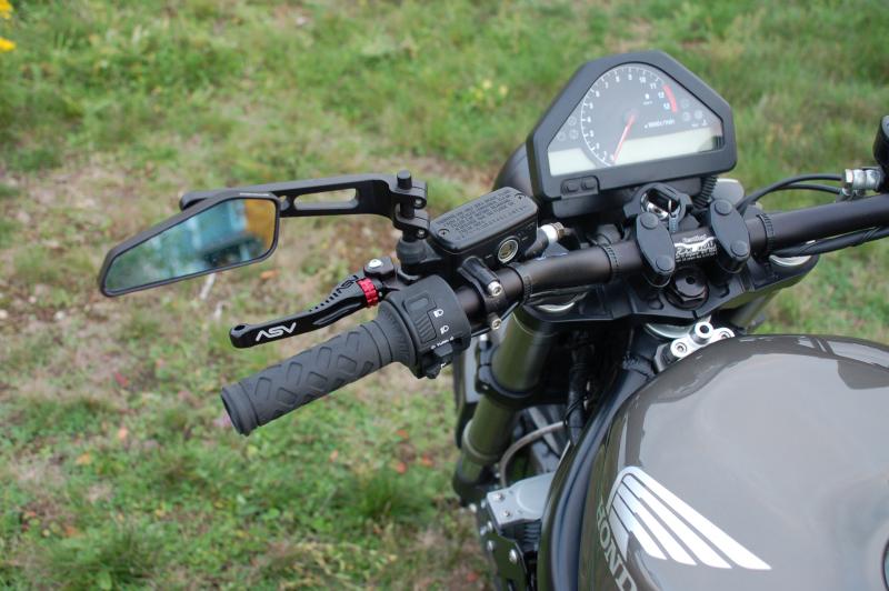

These are fatbars not chopped, they are titled "Mini" and the overall width is that of most sportbikes. As you can see I can fit all switches/controls onto the bars and they don't look too wide or out of place like that on most std fatbars. In your case it would be cheaper to just cut off at this point.

VTS - those look almost the same width as mine (mine are 30") and I figure I can trim at least an inch from each side - which should be close to what I want. Narrower is better. Do you know just straight across from end to end what they measure?
