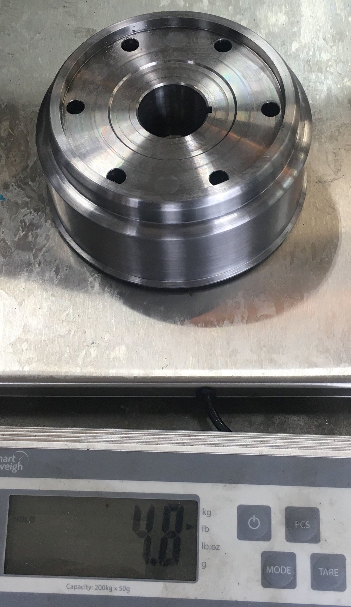

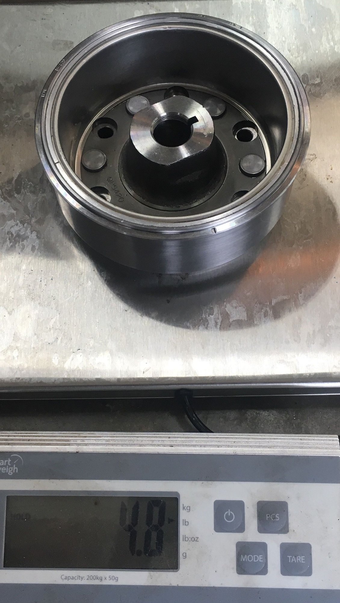

Old Mar 11, 2019 | 12:16 PM
Another rider enjoying the revs
started at 7 lbs. 4 oz. finished 4 lbs. 8 oz.

Eric, You did a great job on my flywheel a while back. I also removed the springs and "extra" gear from the anti-rattle gear to lessen the reciprocating mass a bit more. Didn't really notice a change, but that was 8k miles ago and why not? I kinda' like mechanical noise. Now I'm thinking Titanium bolts for the starter gear as well. Maybe a Titanium retainer nut for the flywheel as well. Is there any weight to be saved on the starter gear?
