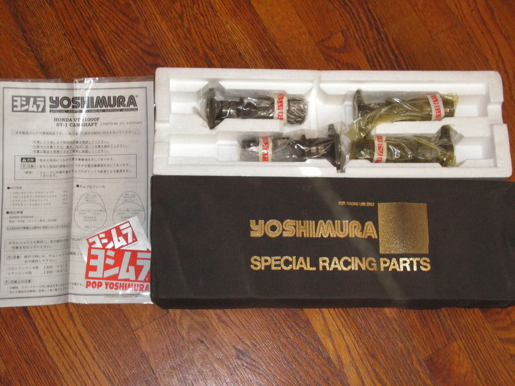

Old Jun 8, 2007 | 10:44 PM
vtrider's Avatar
roll through
Posts: 53
From: San Jose
vtrider is on a distinguished road
I think I got the last set on the planet for $250 brand new. They are discontinued in the US and in Japan. I looked for them for a year and even when I thought I had found some through my friends shop (Evolution Suspension,shameless plug) Some other Jagoff bought all remaining 14 sets and shipped them to timbuktu or somewhere because noone ever answered the phone at the place.(I tried calling them for a month solid)
It was pretty disheartening seeing that Yosh shipped them my set of cams in error and couldn't get them back. So almost a year later (also tried getting Mori cams on my last trip to Japan,out of stock of course) I did my weekly google search and found a listing. The listing was expired and gone but,for the mother of all luck, googles cached page was still perfect and I managed to contact the seller. He told me HE STILL HAD THEM!!!!!!! He sold them to me for 250 plus $15 shipping.
BEHOLD!!
I still haven't put them in,I was wondering if anyone else had them
BEHOLD!!
You bastard! I need some of those and would gladly have paid that price.
hahaha just do a search on google and you will probable find the same page I did. It all depends on how much you want to work for it. You never know,you may come across the rat bastard that has my cams. Lowball him,his cost should be $400 or less from yoshi. I even tried to lowball the guy selling me the cams for $250,what am I crazy?
