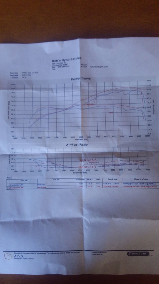

Alright here it is,
I finally had a chance to get to the dyno and the results are in.
Jetting is still way to fat so I'm working on that today but the hard numbers are:
HP: 107.6 @ 8951 =+ 9 Hp
Tq: 70 lb/ft @ 7050 rpm = +5 ftlb
Essentially it is making more power and torque everywhere and a big increase in torque, with respectable horsepower gains over the last session. The next dyno run is in September and I wager we'll see 72lb ft and 112 hp, here's hoping! More importantly, this is very drivable hp with big increases in power after 5500 while using a completely stock airbox and TB slip-ons.

Here was my last run (I did make an adjustment after). This shop has an open house every year and for $5, you got a dyno run w/ print out. After this, the shop sold the dyno so I can't imagine I'll be putting it back on the roller any time soon.

Now that is a damn good air fuel line, what is the secret sauce your running? And what altitude?

Actually, with my prosthetic eyes on property, it looks a tad lean below 4500 ish. Which pilot do you have?

I'm about 5/600 feet above sea level. I honestly can't remember what I have in the carbs. I worked out tuning for a K&N way back and haven't dove in for a while (I'd have to search the forum for a couple days to find the info, I never wrote it down). Before that run, I washed and oiled the filter. After, I gave the fuel screws a small tweak and put a paper filter back in and was hoping to see what it did. Guess I'll never know. Drivability is where I want it, so I doubt I'll be inside 'em in the future.
