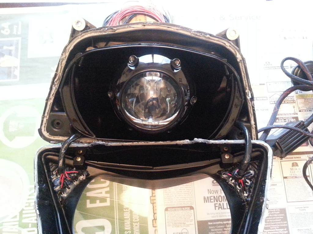

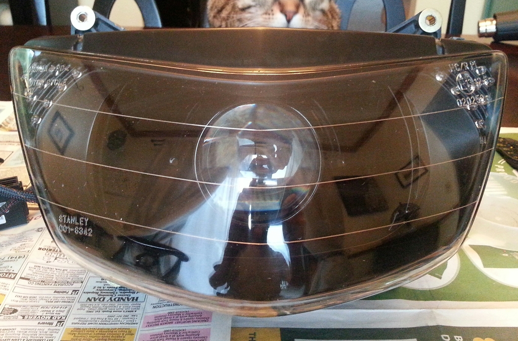

Old Jun 11, 2016 | 07:09 PM
Originally Posted by Just_Nick
Why not take it apart and add one or two HID projectors? You could remove the reflective coating and paint the backing black.
Like this.
Old Jun 12, 2016 | 10:21 AM
barrysuperhawk's Avatar
Joined: Jun 2004
Posts: 116
From: Springpatch, Flatland, Illinois
barrysuperhawk
Originally Posted by CruxGNZ
Like this.
Okay that looks awesome, don't misunderstand my comment about stupid, think of it as a poorly placed to Signature rather than an invitation for stupid comments.
Back to that headlight though, that is awesome. I don't think I'm opposed to hid, I was just more thinking that led was the new hotness. But mostly I just want to be able to see at night.

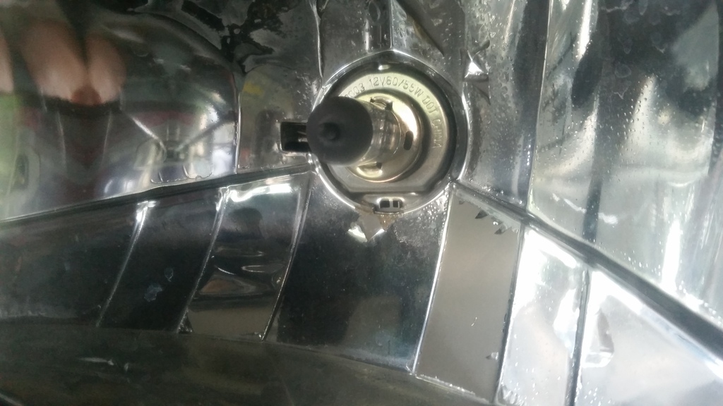

Old Jun 19, 2016 | 09:52 PM
Joined: Jun 2004
Posts: 116
barrysuperhawk
Here's a couple of pics of what is going on.

Old Jun 21, 2016 | 04:43 AM
Posts: 5,221
If your reflector is failing, then buy a HID. It is not that expensive and very easy to do. It is almost plug & play. .
Do they sell replacement reflectors? If the reflective layer is bubbling or pealing and failing, a replacement bulb, be it HID or conventional or LED, will not fix the main issue here.
I say replace it or do the projector mod.
