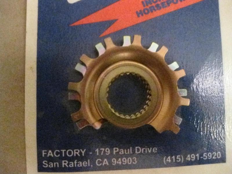

Here is a Factory Pro +4 Ignition Advancer
Notice the number 4 at about 7 o'clock, and also the zinc (gold) plating.
One more thing, since they are discontinued, good luck finding one.

Old Sep 7, 2014 | 08:23 PM
unless a shop has one coated in dust as New Old Stock...your not getting a new one..
Notice the thick layer of dust where my fingers didn't touch on the package in my picture
