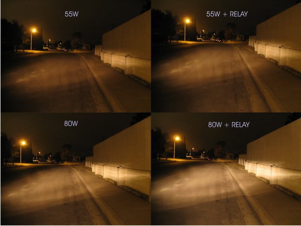

You're better off getting and Eastern Beaver relay setup which will get maximum voltage to your bulb. It's cheaper than anything else and more effective.
I disagree.
The bulb is the best first investment. Although I recommend the relay kit also while you're in there.
Avramid, I don't think you'll find a consensus on the best bulb. But as you can see from the pics you won't regret going with an 85/80 Osram. From what i could find, it's a quality bulb, not some aftermarket gimmick. But I had to special order it because it's not normally stocked anywhere, probably because it's not street legal.

I mounted the relays zip tied to the frame hidden behind the left part of the front fairing. The power wire is routed alongside the rest of the harness. I was also able to tuck it through the battery terminal cover.
Here's what you have to look forward to:
low beam vs stock:

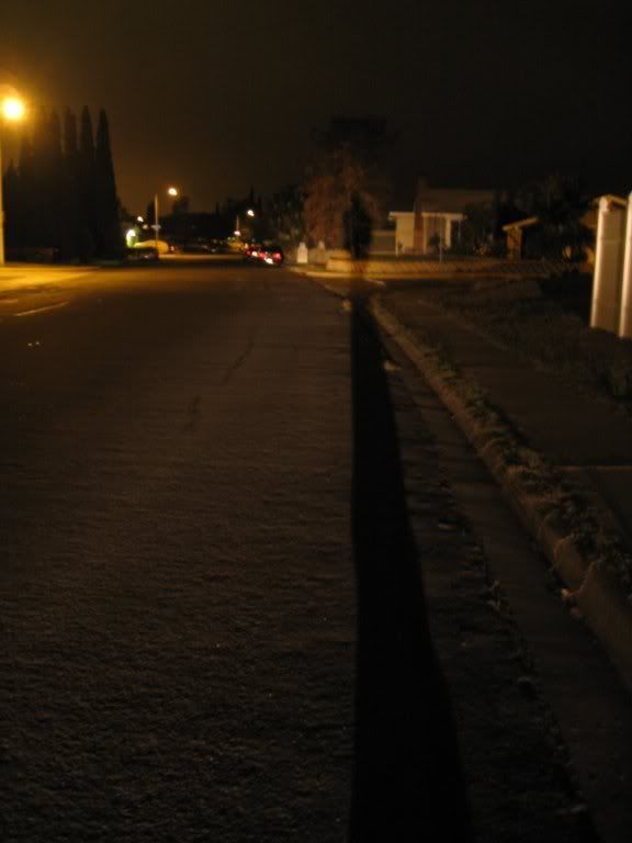

high beam
low beam vs stock:
high beam
Thanks for the advice and photos! Mort
