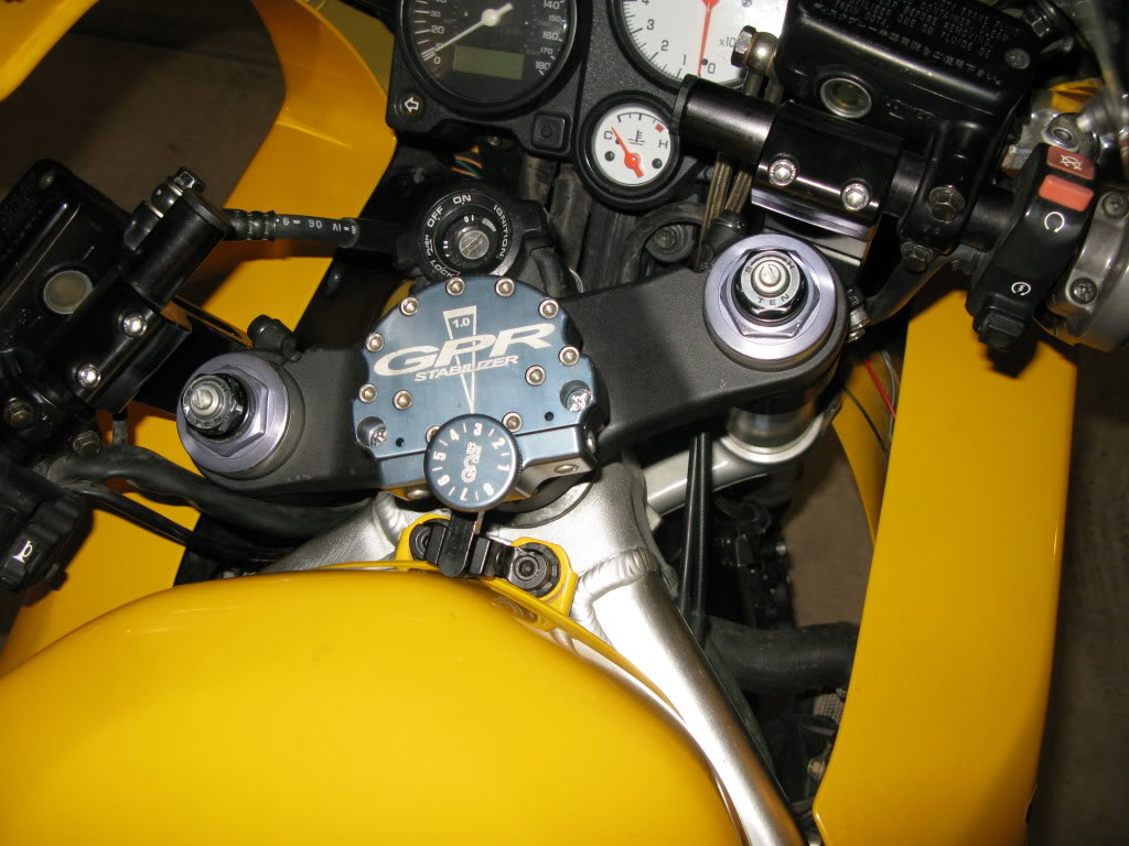

So my latest mod, and final for some time is a GPR stabilizer.. Only one short ride with it on there, but so far I like it.
Here is a picture of it mounted:
I had to create my own system to mount it to the triple trees.
I like how the color matches the 954 forks.

nice look! what did you have to fabricate to make it work? i've been wanting to do a steering stabilizer for a while now. i've been stalking ebay for one that will mount right up... you'll have to keep us posted on how well it works after you get some more time on the bike.

It was a pretty easy install, we used spacer nuts to the upper triple. Clean and it seems plenty strong. He took it for a test drive and came back into my driveway at an angle and the bars never turned on him. Pretty damn good $100 ebay find.
Old Sep 26, 2009 | 10:05 PM
Yep, I drilled the triples and glued some nuts below the holes I drilled for the bolts that go through the spacer nuts.
I think if it had included a 954 mount it would have just worked with no fabbing. But I wasn't going to spend $150 for the mount from GPR on a $100 ebay buy. lol

I think most of the honda tanks have the same tank bolt spacing and since I custom made the triple mount I could adjust the height to fit the mount I had.. The length of the arm is the only fixed distance since you need to center the part that rotates over the steering stem.
