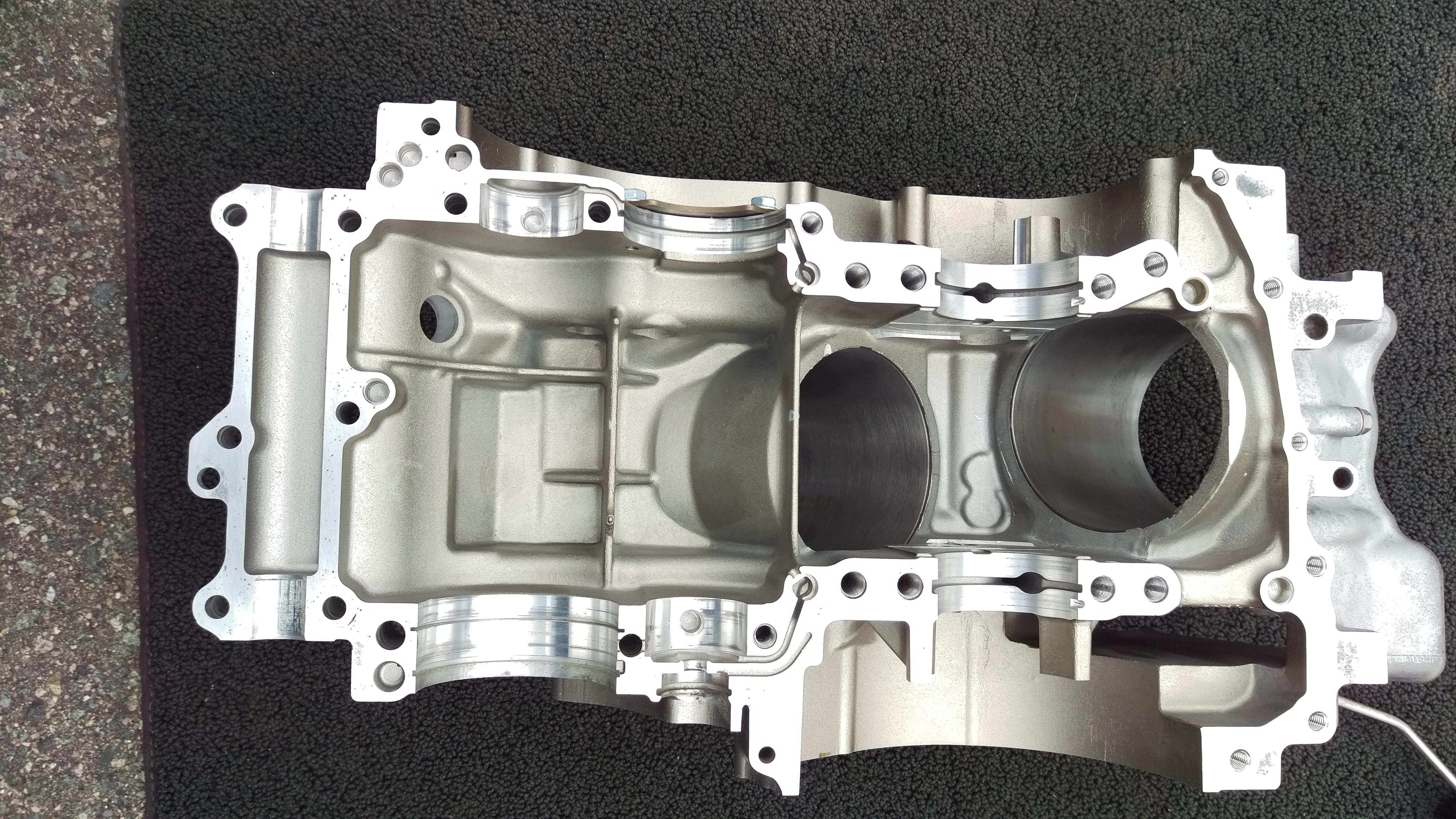

Stopped moving forward.....just waiting for new bearings...etc...and then the rebuild starts...

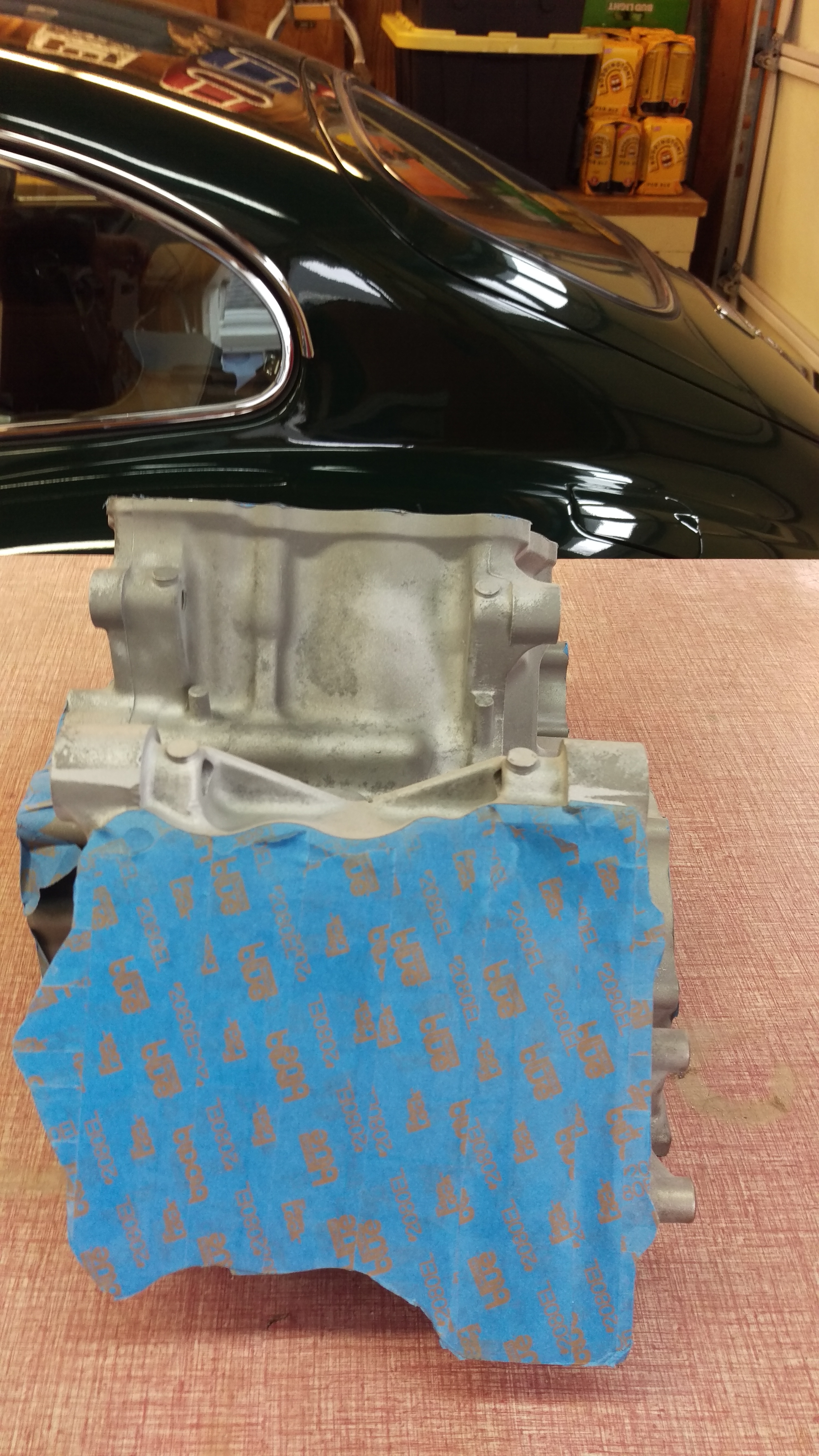

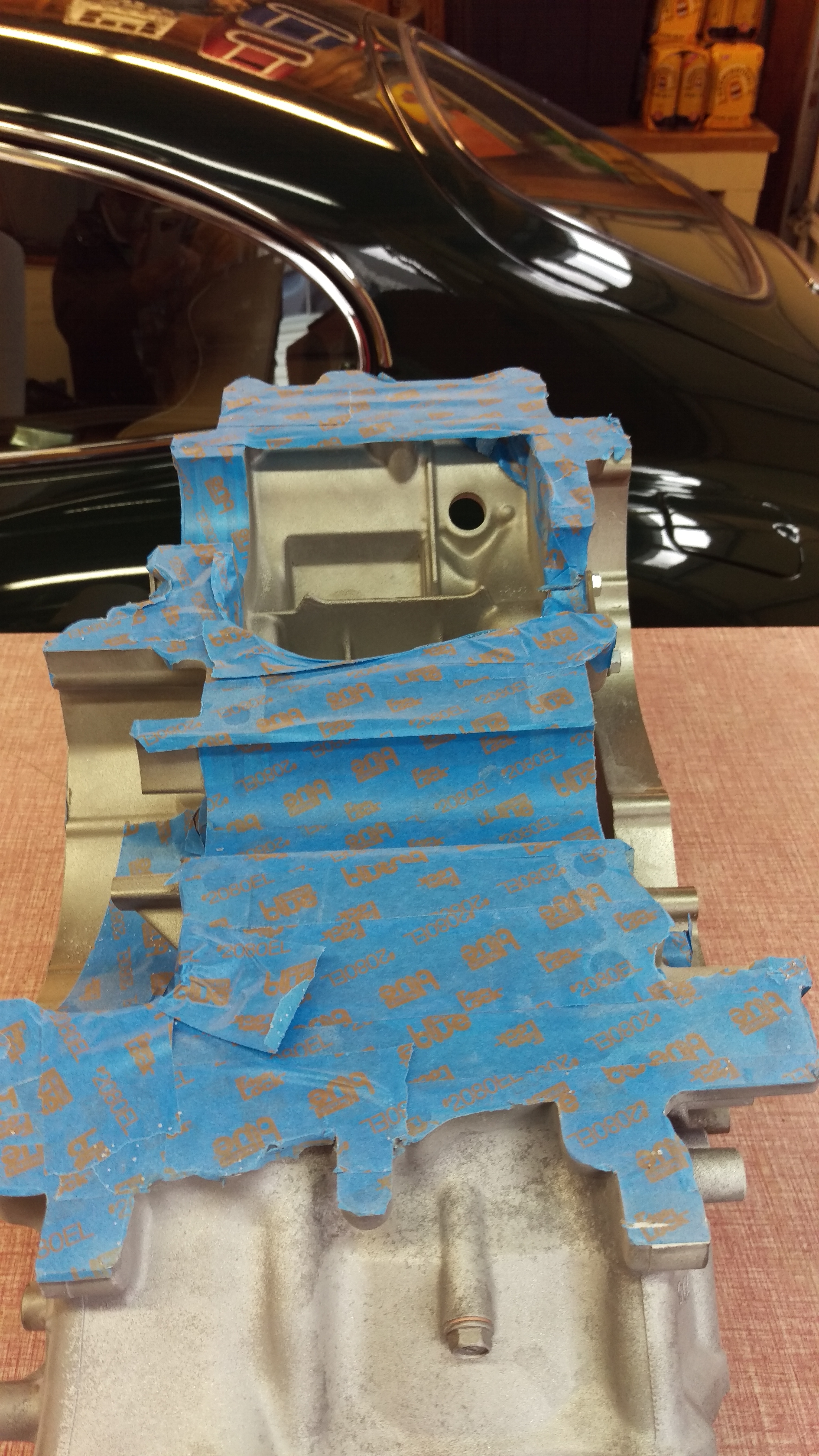

[QUOTE=E.Marquez;405660]Understand I hope you just stripped the protective layer of anodizing off the aluminum... and for post abrasive blast, PLEASE hot wash the case..
I had the cases all taped with masking tape, the cylinder heads, all the bearing surfaces were covered. I was really just attacking the areas where the painted aluminum had gone punky. I intend to paint the whole engine once I get it all together.
Thanks for your input. I will be hot washing the case once I get all the parts ready to assemble.

Here is a better Pic of Taping the Sensitive Parts....?

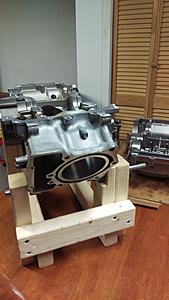

I got home this afternoon....and I was bored...so I decided to make a wooden frame for the block, so when it comes to torquing the bolts down on the con rods and putting the two halves together I will not need to ask the wife to hold the block. I do not know what you guys do when it comes to reassembly.
