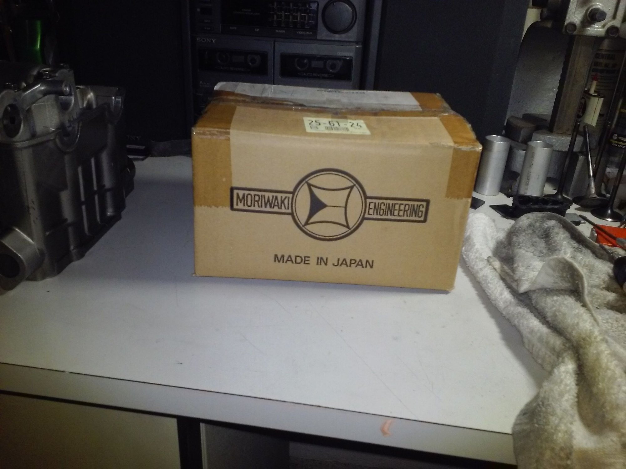

Got a box in the mail
Old Jan 18, 2018 | 10:45 AM
Time for the fun to begin....

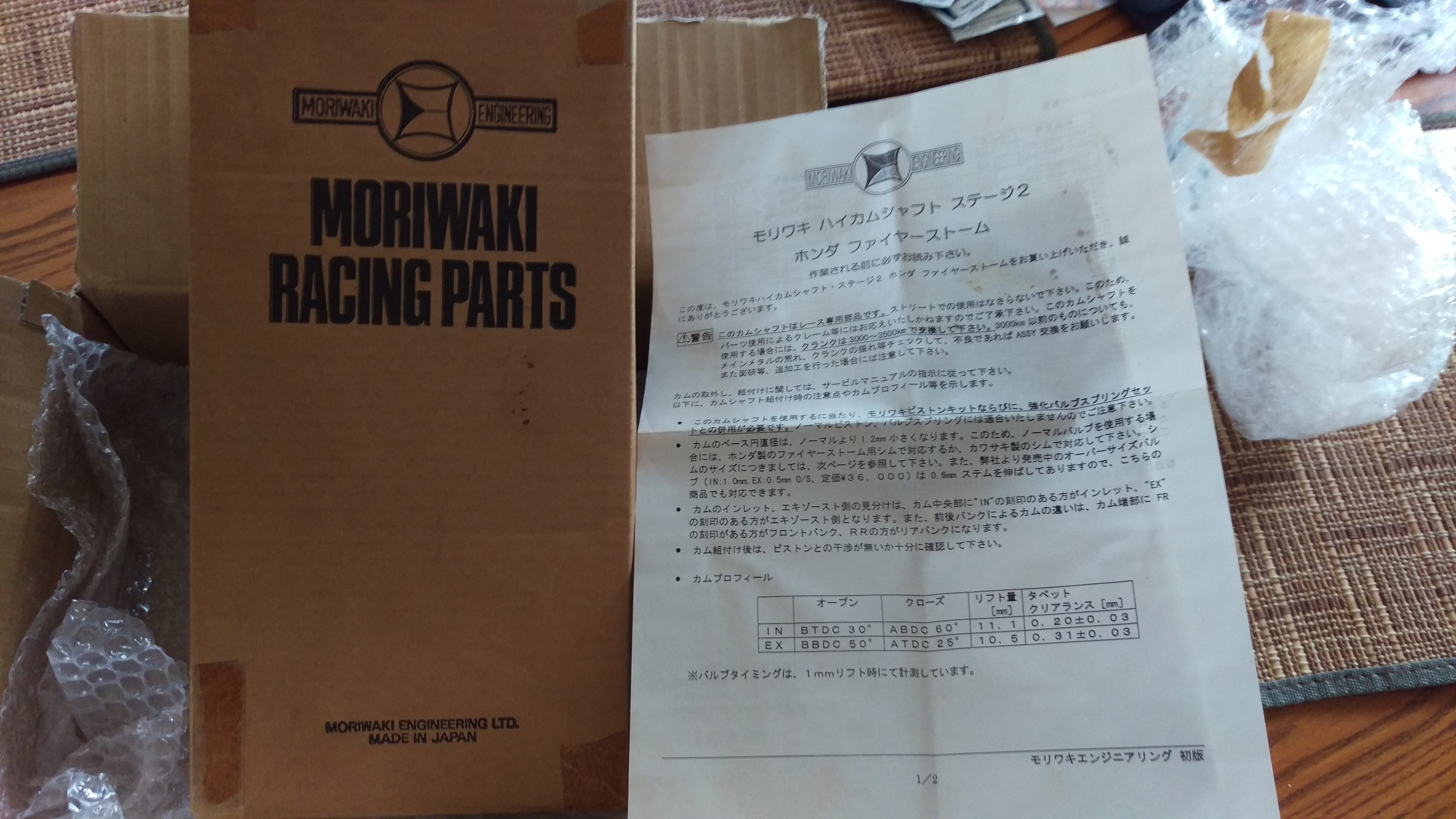

Me Too
I have just got a couple of double overhead "slap shafts" in the mail. I had to use my Klingon bat'leth to open the package.
Attached Thumbnails Got a box in the mail-imag0010.jpg   Got a box in the mail-imag0008.jpg   Got a box in the mail-imag0009.jpg
Old Jan 21, 2018 | 05:04 PM
I have a guy that can translate the instruction sheets if needed.
Old Jan 21, 2018 | 05:51 PM
Bald Eagle's Avatar
Joined: Dec 2017
Posts: 179
From: Quincy Mass
Bald Eagle is on a distinguished road
Thanks... But I belong to a Karate Club and my Instructor is Japanese. I do appreciate your and the forum's help on other matters though.
On the specs that came with the Cam Shafts, it gives the BTDC and the ABDC for the stage 2 Moriwaki cam shafts.
Here they are if anyone needs to know:
IN BTDC 30 degrees ABDC 60 degrees 11.1mm 0.20mm +/- 0.03mm
EX BBDC 50 degrees ATDC 25 degrees 10.5mm 0.31mm +/- 0.03mm
