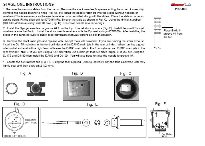

The instruction sheet that comes with the US Dynojet kit says to go up two sizes on the mains and put the needle clip in the 5th notch when using a K&N filter. You're way lean.

Instructions for Dynojet kit #1185.002, U.S. Models
""When running a good aftermarket exhaust with high flow baffle use DJ180 main jets in the front cylinder and DJ185 main jets in the rear cylinder. NOTE: If you are using a K&N filter then use a main jet that is 2 sizes larger... You will also need to raise the needle to groove #5."

Well, since the UK kit was a bit vague, I went off the US instructions, an fitted the 190 jets and put the needle on the #5 grooves to start with an that was really bad backfiring in the midrange, so I changed it to the 180 jets an #4 clip on the needle, an it wasn't as bad, but as you guys are saying, with a filter, that should be running too lean but it doesn't seem to be...
I could just keep going leaner but from what the kit says, I should have to keep it pretty rich.
The only other thing I can think of is if something hasn't gone back together properly, but I've had it apart an back a couple of times an everything seems ok.
It's pretty much on the jetting it was on before now, so the only new bits are the drilling of the slides, an internals, and the K&N filter...
