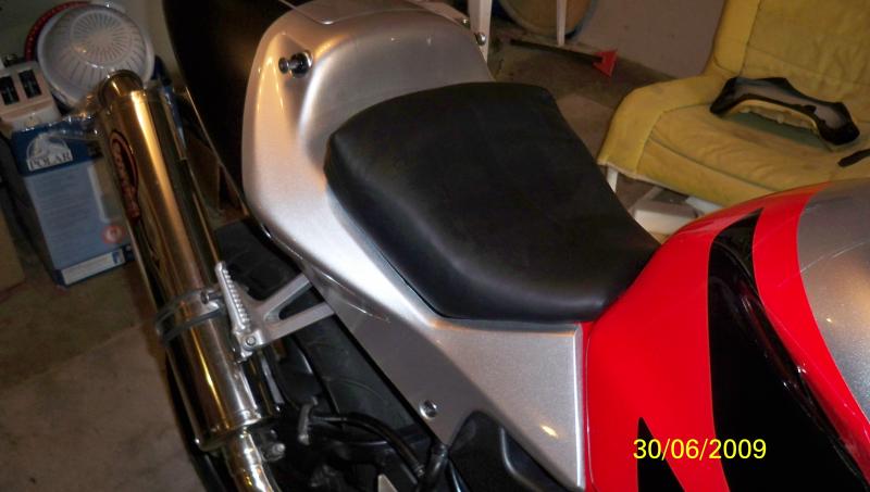

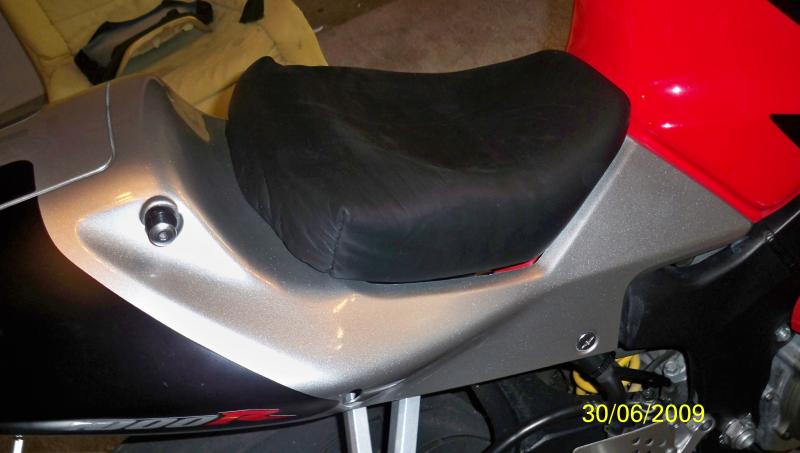

after finding www.diymotorcycleseat.com i decided to try reworking my rc51 seat.
i used closed cell, firm foam. carefully took the old cover and foam off the stock seat. i'll be able to return it to stock if i like.
put the new foam on and shaped it. it's now dished out and wider. check the pics. now i have to figure out what to do for a cover.

Nice going. What's your source for the foam and what tool did you use to 'shape' it?
Old Jun 28, 2009 | 04:35 PM
finepooch's Avatar
Posts: 1,269
From: moncton nb canada
the local auto upholstery shop had lots of different types of foam. the shape it i used an angle grinder. it was almost amazing how well the grinder worked the foam.

i did stretch it over, and could have stapled it. it looked shaky though. i'm thinking leather, and contoured to fit the dish, sides, and meet the fairing.

oh yeah, there is lots of glue, holding lots of pieces of foam together. the upholstery shop loaned me the glue. it's 3m brand.
i've done much more work and the seat is shaping up nicely. i should have it done today.

I've made several seats and I've learned a few tricks. The smoother the foam is the smoother your seat will look when covered. pay special attention to the seams where you glued your foam together, try to get it as smooth as possible. Also if you go to Lowe's or Home Depot and get a small hand rasp it will make the job of shaping very easy. The tool is in the wood working area and looks like a hand plane with a cheese grader on the bottom. Also whatever covering that you use make sure that you glue it to the seat foam as when as staple it to the seat pan. If you don't then the cover will try to float above the foam instead of following your carefully crafted contours.
So far it looks like you have got a pretty good start. Post up some pics when you have it finished.

keep in mind this my first effort

what are you going to call your new seat business, finepooch perches?
Seriously, it looks like if you slide back a bit you'll be hitting the plastic with a little space before it. Seems like there should at least be no gap IMHO.

i don't understand what you're saying about sliding back and the gap. there is a small gap between the seat and the fairing. there will be no sliding because the seat is deep dish style!
