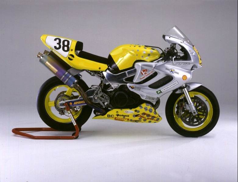

moriwaki and revolution racing also ran that setup on their racebike.
Attached Thumbnails Dilemma: help!!-revolution_vtr.jpg

a proper 900RR fork conversion requires longer stanchions. They were available as an aftermarket part. I don't know if they are still avaliable.
I don't think they ran a fork brace, because the 43 mm stanchions are a lot stiffer than the 41 mm VTR stanchions. I could be wrong. I don't recall Bob's bike having a brace, but he highly recommended it for the stock VTR fork and the improvement was immediately obvious.
The '00 and '01 RC51 fork has the same (or very close) free length as the VTR fork. The '02 up RC51 fork has a top-out spring that affects the last 15mm of travel, so the free length is slightly shorter, if I'm not mistaken.
I almost went the 900RR route, but didn't want to spend a couple hundred $$ on stanchions. Bob didn't thinkg the RC51 forks would work. But it turned out to be a pretty straightforward swap. And I liked the bar position with 929 clip-ons mounted below the top clamp.
