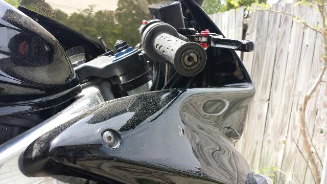

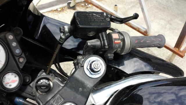

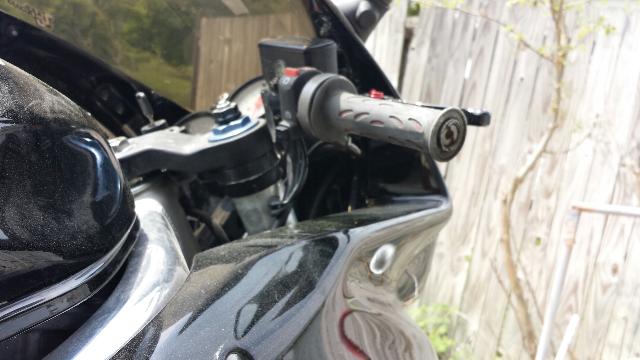

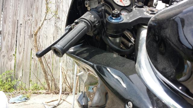

We are 95% done with my CBR929 front end swap and I had a few pics I wanted to share about the clip-on location and the ability to use the 929 clip-on instead of buying aftermarket bars.
Just for reference here is what I have in the swap money wise:
$200 Complete front end
$25 Steering head bearings
$75 Honda OEM fork and dust seals, both sets of bushings and fork oil
$80 Racetech 1.10 springs from ebay from a bike shop that got stuck with a return order.
$80 for two basically brand new 929 front disc from a Fireblades.org member
$20 for a local friend/mechanic to do some shim stack shuffling.
$480 total out of pocket and swapped 4 lights in a paint booth at my buddies body shop for a CBR1000 front fender, this front end didn't have one because it came off a F4i stunt bike.
All that's left to do is bleed the brakes and paint and install the front fender and the horn. When I get time this weekend to get it all cleaned up will post some better shots of the clip-ons and the spacing.
