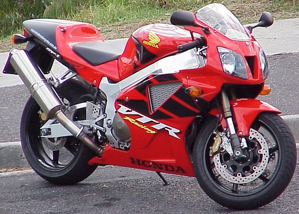

you might be looking at the ignition coil or being from Europe, you might have the SP1 witch is fuel injected and does have a fuel pump...i dont know where it mounted tho...so if your bike looks something like the pic below then you are right. But most of us on this forum ride the U.S. version of the Fire Storm. but because your talking about your carbs its probably just the coil your looking at.
Attached Thumbnails Carb shim mod for non-stock bike????-hondasp1rhfc_600p.jpg

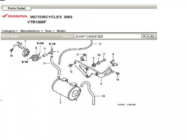

not to beat a dead horse but does that pump look like this?
Attached Thumbnails Carb shim mod for non-stock bike????-zanoj883-12724-albums-my-vtr-551-picture-untitled-3364.png

i know you just posted a pic but im having a hard time with the fuel pump on a firestorm...unless it has some kinda SRAD (Suzuki Ram Air Direct ) mod
