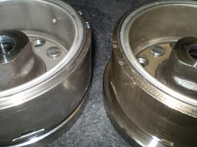

Tell me 7moore, how much weight did you remove from your flywheel ?
I know Marquez took about 5lbs, but not really sure I want to go all that much. Just trying to get a feel....and yes I'm now off the subject at hand.

I bought mine of of Mike (8541Hawk), who had 1/4" turned off of the radius, so 1/2" in total diameter removed. No re-balancing or anything. I never actually measured the difference in weight, but being that all of the material came off of the OD the difference was noticeable (and very fun... I had to learn to use smoother throttle acceleration/deceleration!)
Lighter vs. stock:

Thanks 7. At 1/2'', your in the few bounds area. Bottom line, is that you
appreciate the new engine that came with the mod. I'm looking to do this over the winter, and since I can't test before spring time, I'm looking for
feed back from members and which way they went with this mod in particular.
