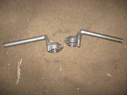

Searched my photos and don't have any of the stock bars. Found these in a thread. Maybe enough to make an ID.
Old Apr 15, 2024 | 06:25 PM
Posts: 2,098
And, since xeris is being so secretive, those look like VFR clip-ons.

You're right. Now that I look closer, the rise is more than stock SH bars.
