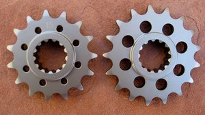

But changing the amount of teeth on a sprocket is a completely different story & not called a 520 chain conversion.
You can change the number of teeth regardless of if you have 520 or 530 size chain & sprockets.
More or less teeth on the front & rear will give you more or less acceleration & also change your top speed.
Do a search on this forum & you will find plenty of infomation about how many teeth guys are running on there bikes, & the effects it has on the performance.
The below photo is of two front sprockets, the sprocket on the left has 15 teeth, the sprocket on the right has 17 teeth.
Attached Thumbnails 520 Conversion, please explain-left15toothright17frontsprockets.jpg

Ok, some coherent thoughts for you. Everything HondaVTR1000SP2 said is correct, just sounds like ramble.
Got -1 +2 will give you a lot of OMG factor. If you search for 15/43 you will find plenty of discussion about it. That is the new tooth count.
The 520 conversion. That is changing the width of your chain and sprockets. Depending on who you talk to, the 520 is as strong as the 530. Where the excessive wear/replacement lies is, that most users choose to do an aluminum 520 sprocket to save on weight. The aluminum wears faster, so your replacing the pieces/parts more often.
A 520 conversion with steel sprockets should see the same type of life as the 530.
The reason for the 520 conversion? Less rotating mass. More horsepower/torque to the wheel.
You can do the 15/43 without doing the 520, and vice versa.
Start with the 15/43, it will give you all the OMG that you want. I love it.
Hope this was a little more coherent.
Erik
