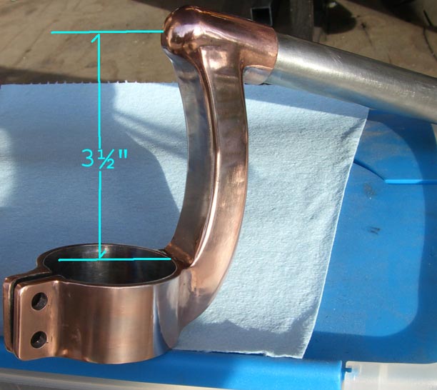

I made my own. Here is a shot of them going on.
Attached Thumbnails 50mm Clip-On's For RC51/954/929/1000RR Fork Swap - What Did You Use?-cimg2131.jpg
How much rise do those have?

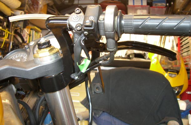

I used Ducati 900 SS Helibars.... they have a lot of rise to them, so you could easily use a RC or 929/954 upper triple and still get these bars in a good spot.
Attached Thumbnails 50mm Clip-On's For RC51/954/929/1000RR Fork Swap - What Did You Use?-ducati-900-heli.jpg
It is 3½" from the top of the fork clamp to the middle of the bar inner end. Does that make sense?

Old May 24, 2009 | 08:00 PM
Makes perfect sense with the photo! Thanks!
Old May 24, 2009 | 09:19 PM
That's the same rise as my Swatts, but with your design your bars are further back than mine, so you have a more upright seating position (not that mine is all that racy)

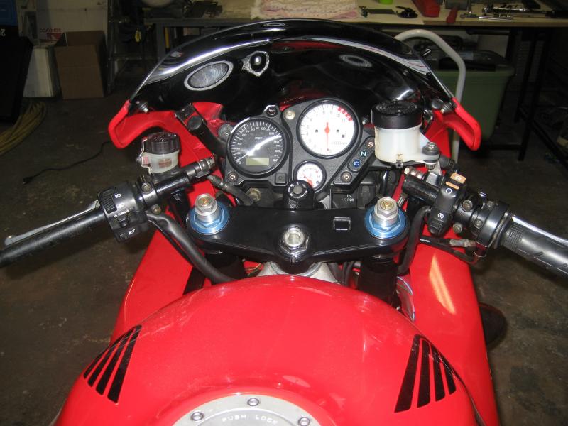

Hey Lazn, do you have any fairing interference with the Swatt's? Are they flush with the underside of the triple clamp?
Old May 24, 2009 | 09:41 PM
No, and yes. I have them fully flush with the bottom of the upper triple, and to prevent any fairing interference I have them rotated slightly backwards. (about 1/4 inch from as far forward as they could go)
Setup like this there is no interference at all and the reach is quite comfortable.
