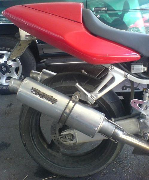

So I got a pair of rattly 2 Bros from Anto here, tore them apart, fixed the baffles/repacked, cut them down about 2 inches and stuck 'em on.
Oh. My. God.
Why did I not toss on an aftermarket pair any sooner? These sound -awesome-. A little burbly, but I think the jet kit I'll install soon, and all the associated tinkering, will fix that right up...If I even want to. Being a fan of classic muscle, that burble just lights my face up
Now I just need some new rubber...

Ok, next question...I can understand the backfiring and burbliness of the new pipes, but when I'm in 1st gear and above 3500 rpms, I get this odd noise from the engine. It's a hissss-TICK and I just can't figure it out. It makes me think of the engine trying to turn over when you have the cut-off switch engaged, and I can feel the power disappear for that split second, but then it's right back to normal. Any ideas?

Is it maybe a carb backfire? You probably could use a rejet with the pipes anyway. When I bought mine it wasn't set up right and I got all kinds of carb backfires from 3k to 4k. Just a guess...

Hmm...That could be it, especially given that the 3k-4k range is exactly where it happens on mine. Good thing I had the rejet planned, but is it potentially harmful to the bike or will riding around a bit before I get that done be ok? Obviously not 500 mile rides, but commuting and maybe a 100 mile jaunt once before I take it in in two or three days....

It can't be good for it, but I drove mine like that for probably about a month while I got it sorted. As long as I avoided steady throttle between 3-4K it was ok.
