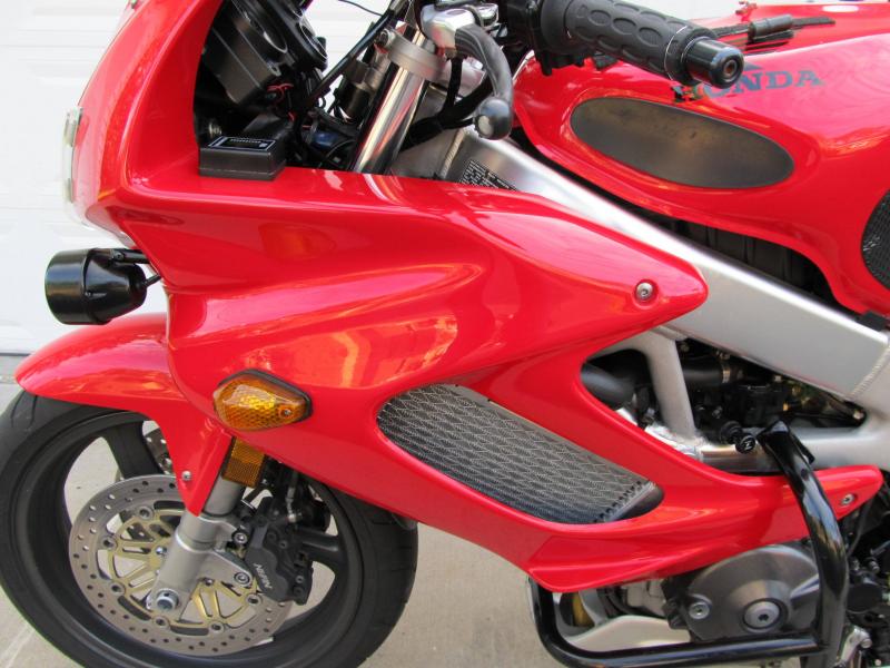

what 95 cage? Could be apples n' or.... Paint damaged thru to plastic must be painted to restore anywhere close to new
but
Honda has thick total dft and if not thru n' thru can be laboriously hand and or power tool polished with https://www.google.com/search?q=mcgu...ient=firefox-a
see photo of my left fairing, it was damaged and I restored it with Scratch-X (original not v2) 2 years ago and I have just kept polishing with cheap liquid "wax" (New Finish type stuff) and clean with kerosene, 91% iso alky (carefully) and Spray-Away window cleaner, and localized Scratch-X as need due to 80k miles wear n' tear. I use mostly microfiber cloths and super soft old cotton unde's n' t's which I wash a lot. Toothbrushes with Spray-Away is a killer dead bug remover with a McGuire's spray detailer for touch-up between more.
