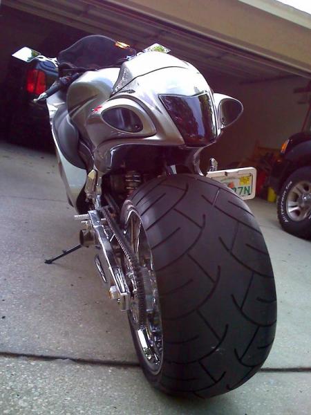

SH 240/250mm Wide Tire Kits
Does anybody know of a company that makes a 240/250 tire conversion kit or someone who can modify my swing arm to accept that size tire? I already have a rim and tire that is on my South Florida Chopper. Any technical advice would be greatly appreciated. Thamks, Brad.
