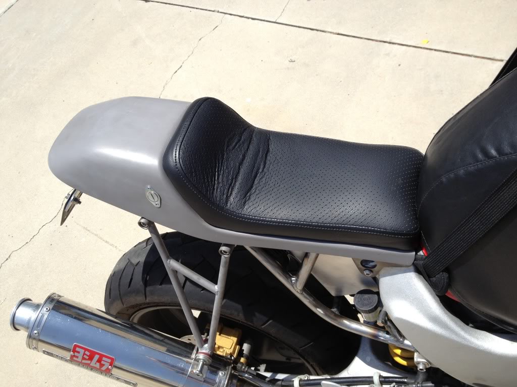

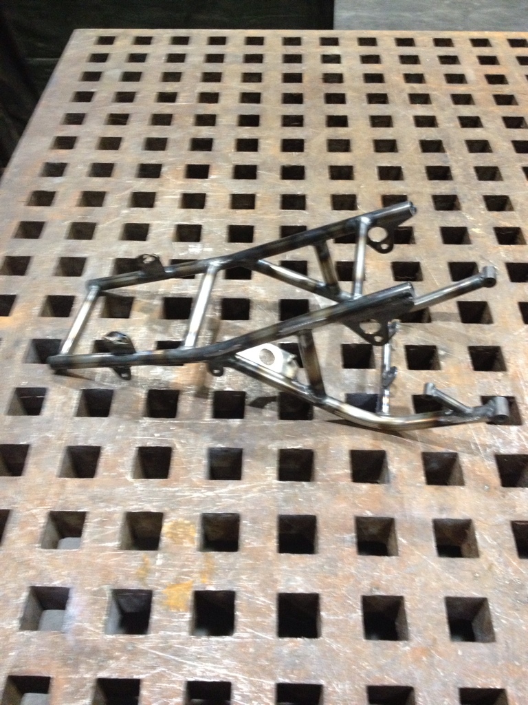

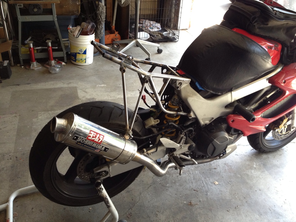

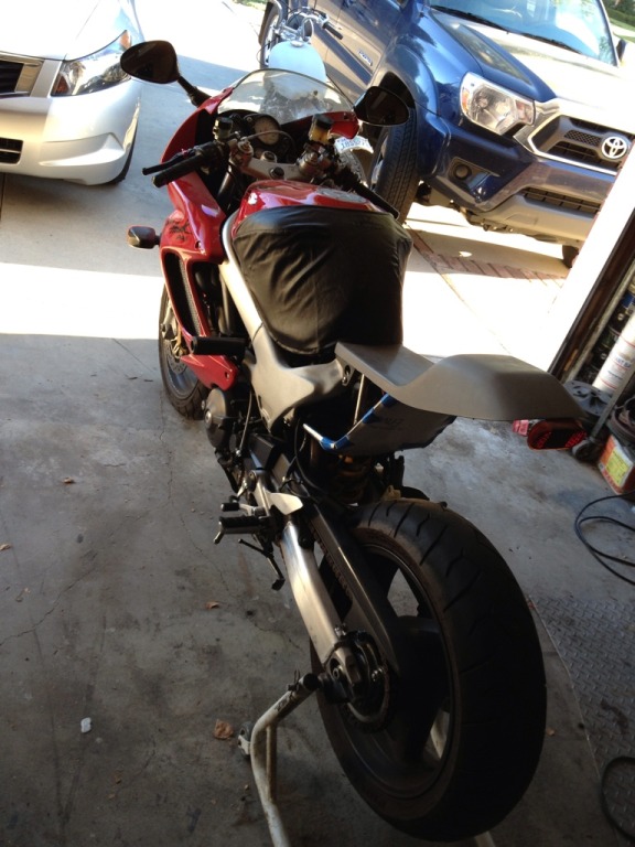

This is part 1 in a redo of my SH which will include a R1 front end, rims, dunlops D616 tires, Moto Guzzi 1/4 fairing, renthal bars, custom top tree and risers, and much more. I started from the rear in order to define the lines of the bike. Pics:

Looks good so far

Do you have any full bike pic with that sub frame on it

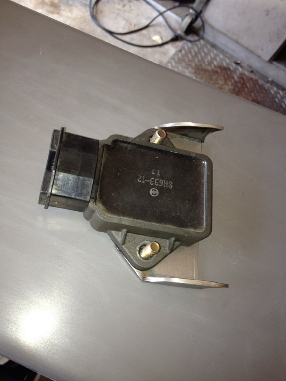

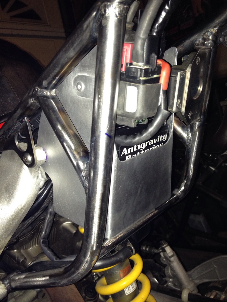

I'm using a 1940 Chevy tail light w/ a couple LED clusters. I started making tabs for the coil, brake reservoir, starter solenoid, regulator, etc, and mocking up for the aluminum skin.

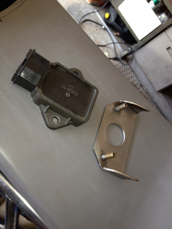

Old Apr 2, 2013 | 10:27 PM
Nice bracket, how about changing the R/R for a better one?
Old Apr 2, 2013 | 11:31 PM
WOMPY5000's Avatar
Joined: Jun 2012
Posts: 15
From: Corona CA
WOMPY5000 is on a distinguished road
Which one ? I saw a thread on that but was unclear on year and model of bike it would work with. Same mounting pattern I hope?!?!?
Old Apr 2, 2013 | 11:50 PM
Here is a thread that will give you all the info you will ever need about this subject:
https://www.superhawkforum.com/forum...why-how-25117/
You can also get the new replacement for the R1 R/R as a kit from the same manufacturor, it works really well and will outlast the bike:
Shindengen MOSFET FH020AA Regulator Rectifier Kit Replaces FH012AA | eBay
This is one of the two most common biggest issues on these bikes that may end up very costly, the other one is CCT's, it is recommended by many to give these two items preventive measures.

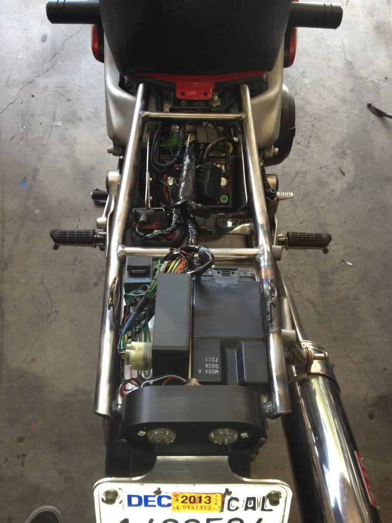

Top view of electronics stuffed in with seat pulled off :
And, new perforated leather seat...

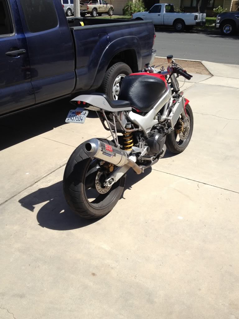

And here's a side view of finished rear section (still needs powdercoat). I doesn't flow with the front at all, but if you read my first post you'll know what is coming next: aluminum side skins and Moto Guzzi 1/4 fairing w/ 5" headlight, new wheels, inverted FE, custom top tree, renthals, and trail tech speedo/tach.

And now we're naked !!!!
