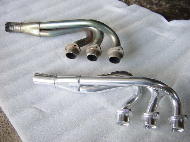

If you want really durable and shinny exhaust headers, send them to JetHot coating:

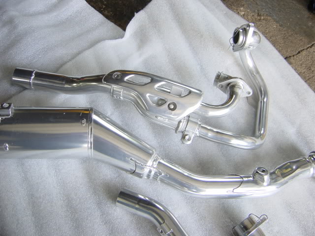

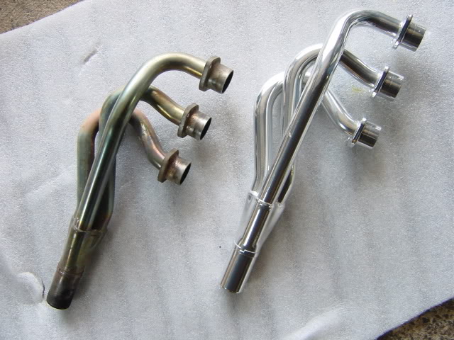

For the 2000 Honda VFR800:

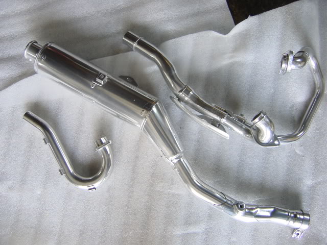

For my Supermotard XR650R and dirt bike WR250F:

I did the same with my Superhawk header pipes, $175, ceramic coated inside and out, cut down the heat between the legs and the engine seems to run cooler, too.

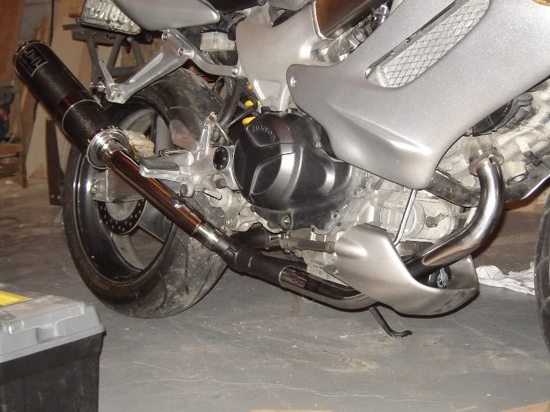

This was after about 10 minutes of idling and a quick run up my street and back. They started out looking like slightly polished (not mirror but slightly shinier than stock) stainless.

Personally, I've had ceramic coated header pipes on my 1987 BMW K75 since 3 years, 40,000 miles ago, the header pipe still looks the same as I received it, the color/shine never faded, ridden in all kind of weather.
The main reason I choose to use the ceramic coating for the headers is because of the heat insolating property. Because the ceramic coating is inside and outside of the header pipe, the heat from the engine exhaust is kept within the pipe until it gets to the muffler.
For a Superhawk, with the rear cyclinder exhaust cooking the rear shock, the ceramic coating not only reduce the heat between the rider's legs, but also prolong the rear shock oil's life span= less shock rebuild. The suspension performance is drastically different when you have less heat near the shock body. For that the ceramic coated headers are well worth the money.
