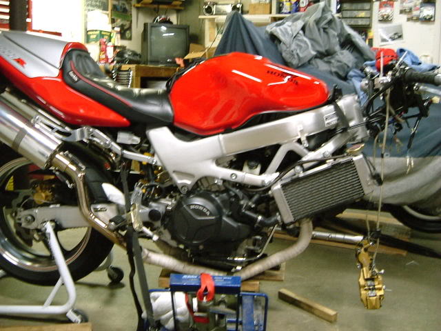

Here is a distant pic of the rear wheel stripped to near the center. You do not strip all the way to the center, just to the machined lip where the surfice feel rough

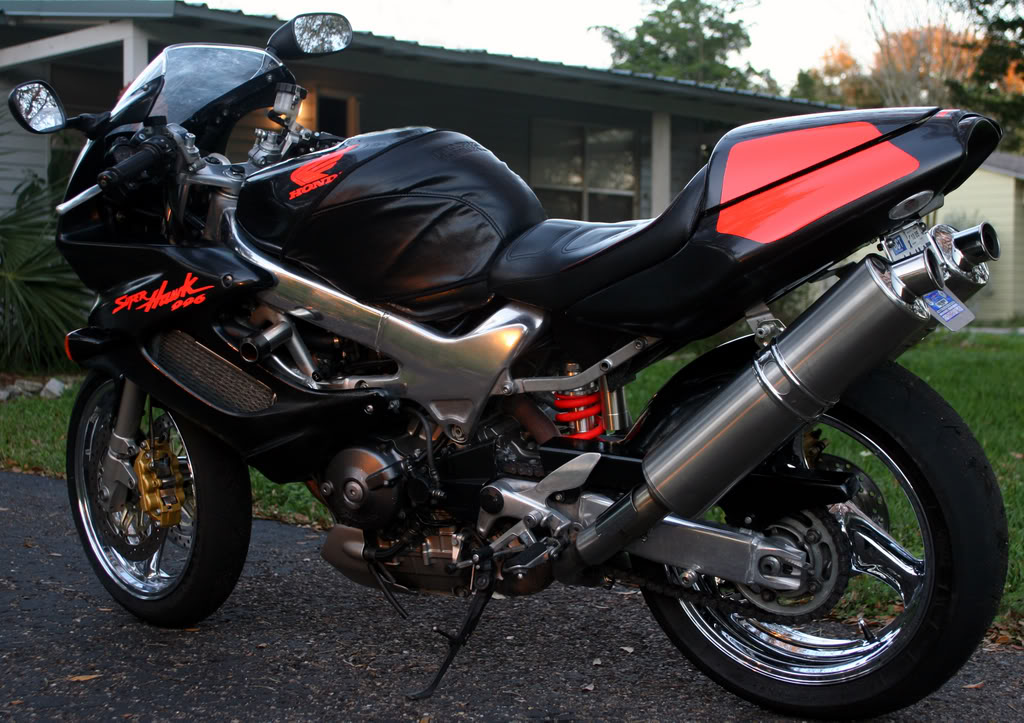

I bought superbling with a polished frame/swingarm and chrome wheels so you know how I came up with the name and the upkeep between the two on a day to day basis was huge.
If you can handle the costs and weight penalty, chrome is better IMO. Although cheaper, polishing is very labor intensive and high maintenance (unless you live in a dry desert). The bare aluminum will oxidize and dull. Here's a pic shot right after shining it all up. Notice the diff?
