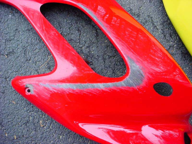

when i bought my bike it had ben dropped on the left side, it has a few scratches in it. is there something that i can buy to do the repairs to it so it doesn't look so bad?
here are a few pics:

Looks ok like it is. If you put filler in it, the color will be grey or tan depending on type used unless you plan to paint it.

I'd replace the fairing before putting too much work into that one... seeing as how that one is missing a good size chunk by the air duct.

my plan was to sand it, fill it, then touch up the paint

it looks like it was dropped at a low speed.
Originally Posted by joshuatest
which lower is that? just curious?
not sure, got it like sits
i can live with the chunk missing but, the road rash i would like to get smoothed out and painted red, if you look up near the headlight, a friend had some red brake caliper paint, i spray the paint onto a piece of cardboard them wipped it on there to see if it matched up, and it did seem to match, but the was only one coat to just look at it.

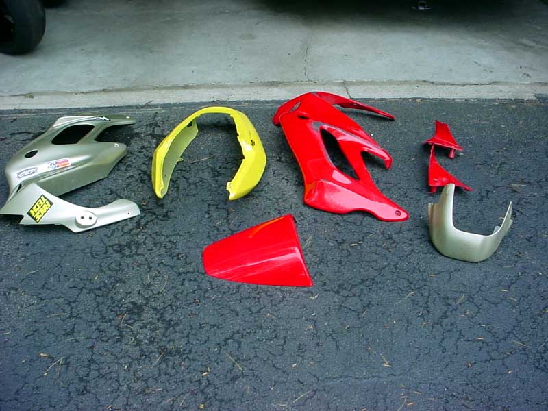

No, my bike is not on their website, though there is one that's mighty close.

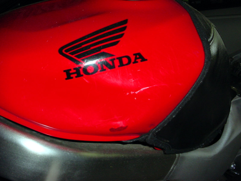

Mine started out like this:
Attached Thumbnails plastic body filler?-mix-n-match-fairings-sm.jpg   plastic body filler?-left-side-2-sm.jpg   plastic body filler?-dent-tank-sm.jpg
Old Feb 15, 2008 | 06:10 PM

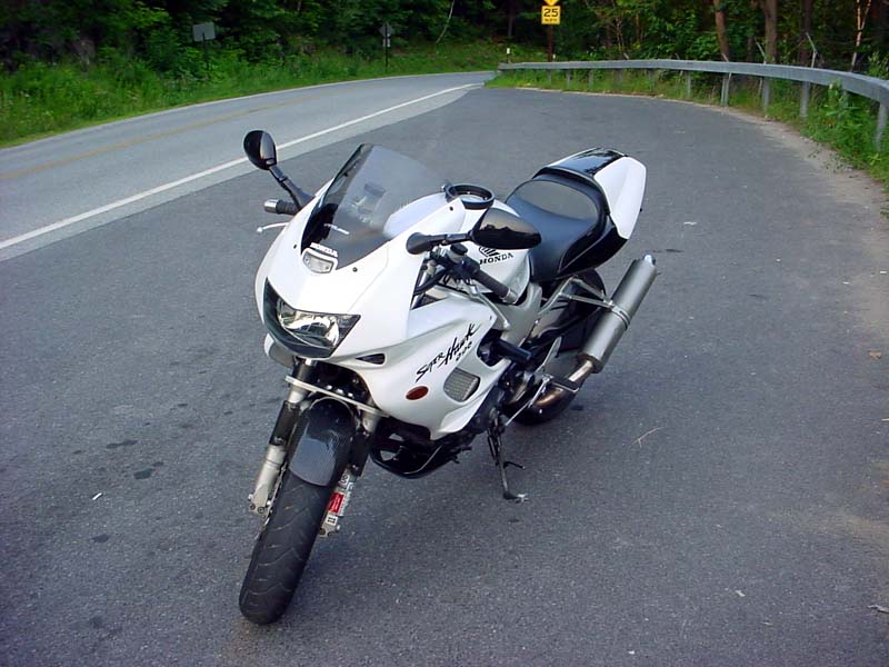

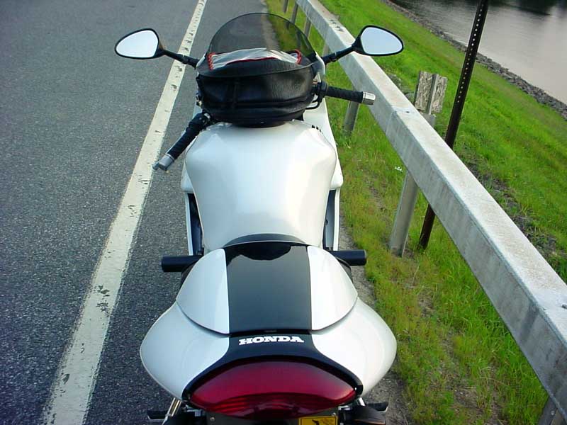

...and $600 later ended up like this:
Attached Thumbnails plastic body filler?-hawk-lake-4.jpg   plastic body filler?-hawk-lake-9.jpg

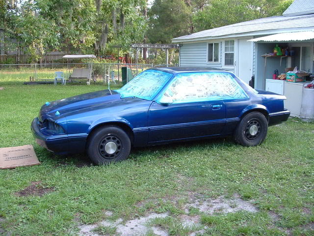

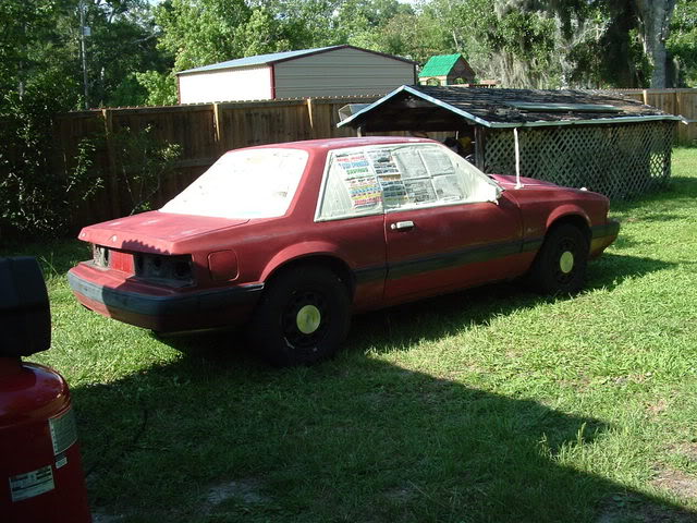

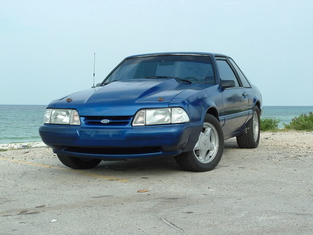

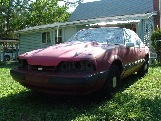

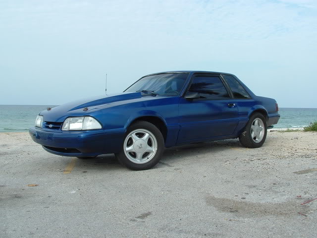

i had a mustang that i painted here are some pics:

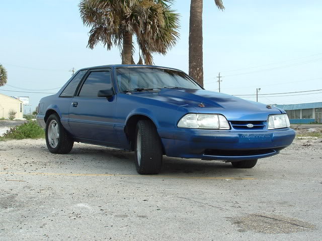

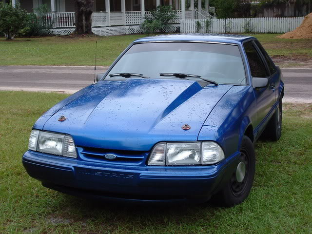

then after i was done:

after a few months

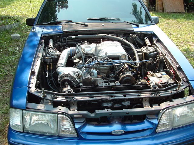

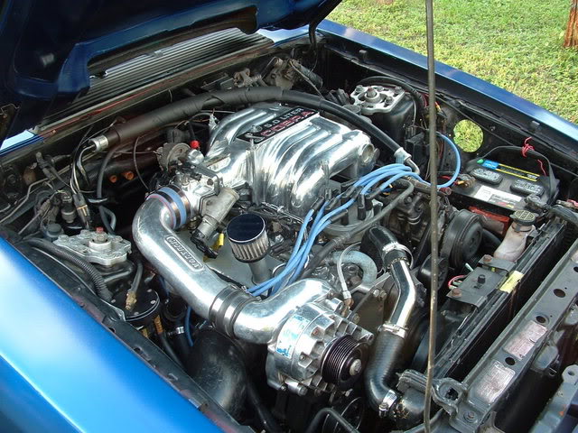

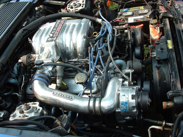

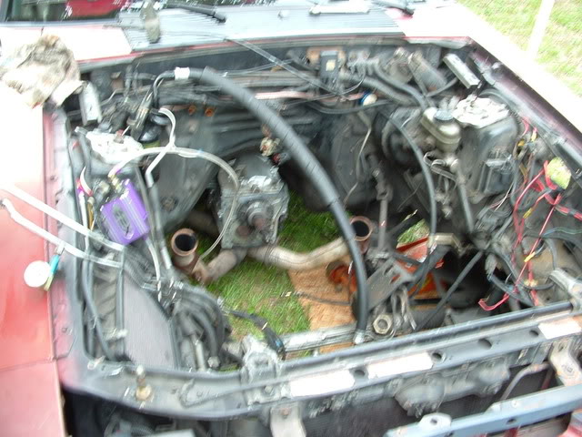

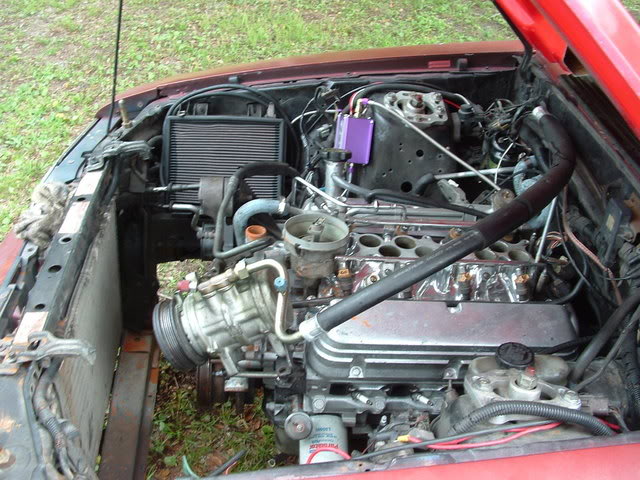

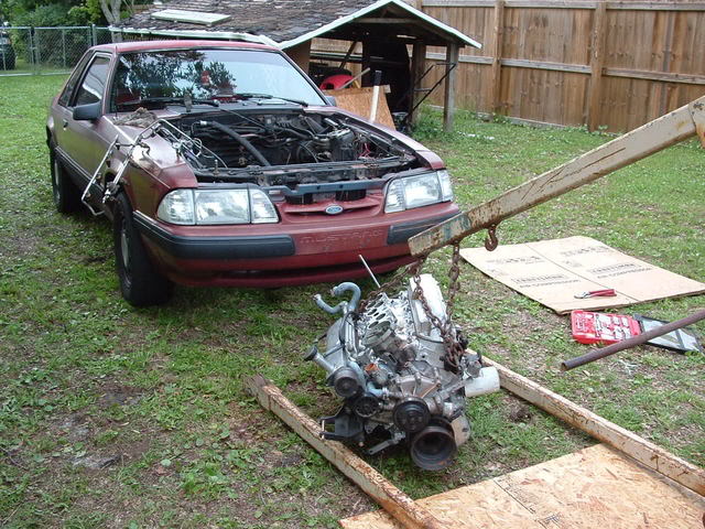

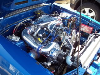

the engine i built and installed with Vortech supercharger
after all the paint and engine work

I used the twin syringe plastic welding stuff from walmart or napa, you squeeze it out and stir the two sides together, then apply. I ground a groove along all my cracks (both sides) and filled that stuff in, then sanded it smooth on the outside after it dried for a few days. I also sanded down to good plastic on the same areas you have scuffed up, then sent it to a painter. Fixed the left fairing for $55 total.
