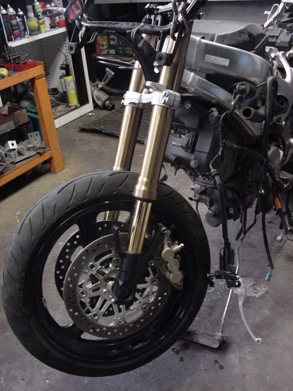

Well this morning I slid the Hayabusa forks in and it looks like I can use the VTR front wheel as the disc spacing is perfect. I will however need to get different bearings for the axle to fit correctly.

[QUOTE=PappySmears;314198]Well this morning I slid the Hayabusa forks in and it looks like I can use the VTR front wheel as the disc spacing is perfect. I will however need to get different bearings for the axle to fit correctly.
im curious about the busa front end,is the length of the forks the same as vtr.is it at stock height when all put together etc etc....just would like to know how close to stock it is as far as the specs go.

Saige, I will measure it up for you, but bare in mind the Busa front end sits flush with the top of the fork clamp, where the VTR protrudes through.
I'd like to know the same. There is a few front ends for sale on Ebay right now for a resonable price.
Old Sep 21, 2011 | 10:36 PM
PappySmears's Avatar
Joined: Sep 2011
Posts: 139
From: Australia
PappySmears is on a distinguished road
Length of the Busa forks are 750,, The VTR are longer but protrude much more through the top yoke. I will be using under yoke clip ons.
Thanks for that. I guess if the geometry is that far off, as in it brings the rake way in, you could always lower the rear a little to make it not so twitchy. I'd love to hear a ride report when you all done. This thing is going to look sweet when you're done. Definitely one of a kind.
