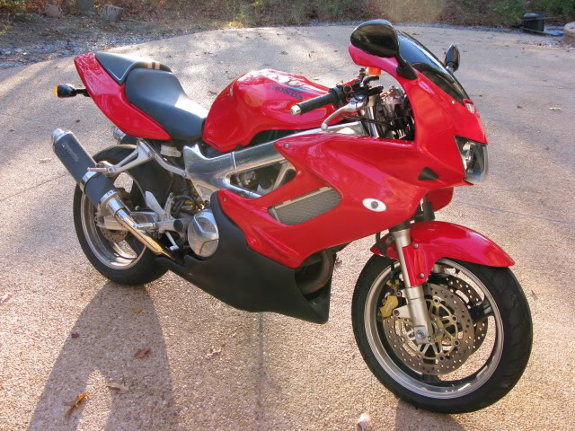

The weather warmed up enough to paint my 98 Superhawk. The PO had the bike knocked over in a parking lot and the fairing was cracked/scratched in several places. The tank was also dented in a few places from previous incidents. I repainted, using Honda (car) "Milano Red" which is a tad bit darker/richer than the OEM color. Need to wet sand & polish out a few gnats that decided to do a Kamikaze attack on the wet clear coat. While I had the bike apart, I also did the following:
--Manual CCT's
--SS braided brake/clutch lines
--Super bike bars and risers
--LED taillight
--Buell footpegs
--Headlight modulator
--"Magnum Blaster" horns
Pic's:
Before:

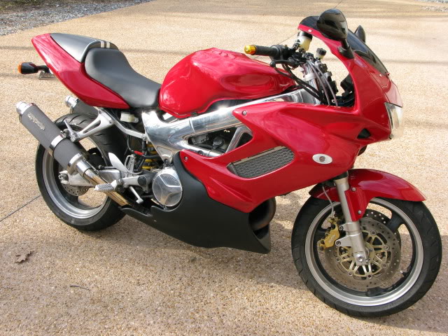

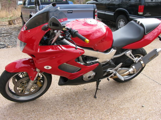

After:

Nice job. Not sure but I think I like the gold bar ends.
Old Jan 20, 2010 | 12:49 PM
ttocsmai's Avatar
Posts: 250
From: NJ/NYC
Silver or Black bar ends are better, especially if he is not going to paint the lower. But it is only an opinion and it is his ride.
