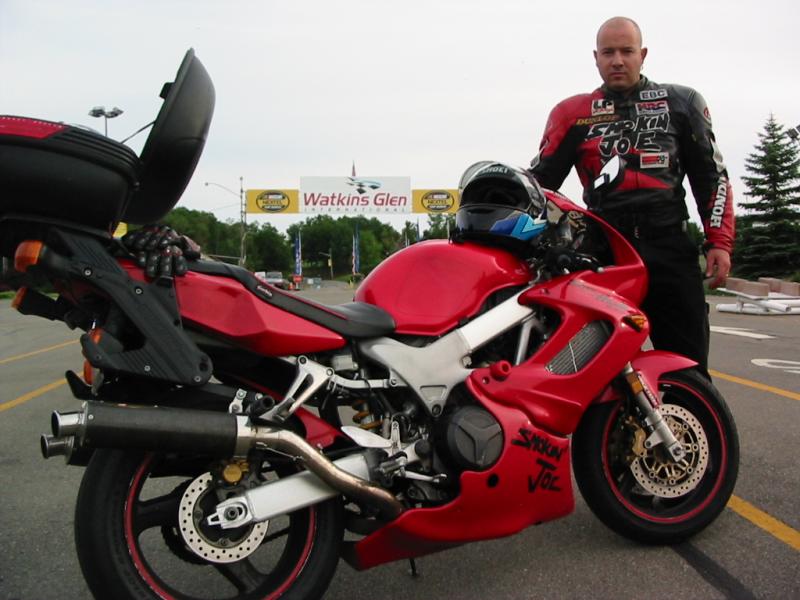

This set-up allows me a 52 liter top case (givi maxia) that easily holds 2 helmets, along with 2 45 liter side boxes (2 helmets each also) AND my wife.

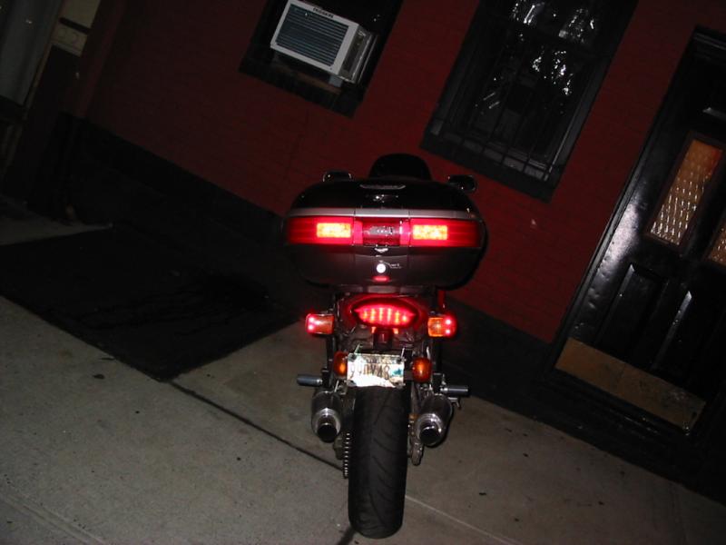

Oh yeah, that must have been a beautiful trip. The givi stuff is 100% waterproof & pops off to carry into a hotel. I modified a wing rack I had on my CBR600f3 slightly. (Drilled some holes, added some bolts. I also added a brake light in the top case for conspicuity, as well as red LEDs in the turn signalls to give a larger rear signature at night. (not seeing you is #1 on the box jockeys that hit you excuse list)

It is a triple rack so the side cases pop onto the "wing" looking things & lock on. The top case in the pic can be popped on the side too. I will see if I can find some more pics that show it. It all bolts to the subframe & passenger pegs. The side cases fit right behind the passengers knees. I will search for a pic.
Old Dec 29, 2008 | 08:08 PM
OK so here is a link that shows how the wingrack looks on a bike(VFR in this link). The rack bolts to the pass pegs & I have mine hanging directly down from the sub frame with flat steel that came with the rack. To make the whole setup narrower I cut the tail plastic so the bags would suck up to the subframe. Now with my E21's (21 liter side cases) I can lane split as the bags are as narrow as the mirrors.

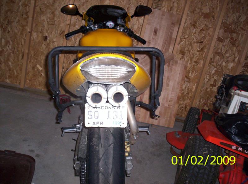

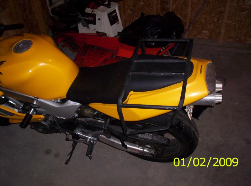

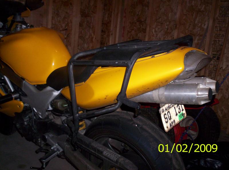

Here are some pics
Here is the rack I made. Any questions, ask...
Attached Thumbnails Luggage rack-000_0341.jpg   Luggage rack-000_0342.jpg   Luggage rack-000_0343.jpg
