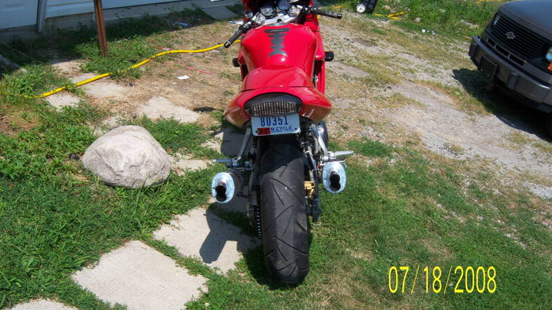

Got LED Taillight and turn signal installed... pics...

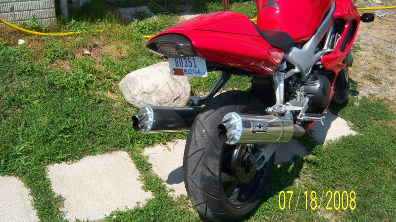

I got a smoke tinted one off ebay and got it in 4 days! Was really pleased. Has the red LEDs for light and breaks, and amber for the turn signals, and hyper white for the liscence plate. Took me about 15 minutes to install with no directions. Here are some pics let me know what you think....

I also got the HID headlight in yesterday, and man did that made a difference last night riding!!

looks good

Hope you installed a relay for your HID, even thogh I don't condone HID kits as they cause glare over a HID projector retrofit. Main thing is the stock harness might fail over time because of the ramped amperage draw on start-up mode with the ballasts. One ballast can draw nearly three times as much amps as the stock halogen bulb did. Be careful. HID is a hobby/side business of mine.
Tail looks good. I thought about purchasing that unit but wasn't wanting to sacrifice maximum lighting visibility. I do like the smoked one better than the clear one in terms of looks!

Hey that looks great! Which store on ebay? can you post the cost and link?

I got the taillight for x3 racing...
http://stores.ebay.com/X3Racing
Paid 67 bucks shipped with priority shipping. Now I gotta sell my clear tail light and fender eliminator kit.

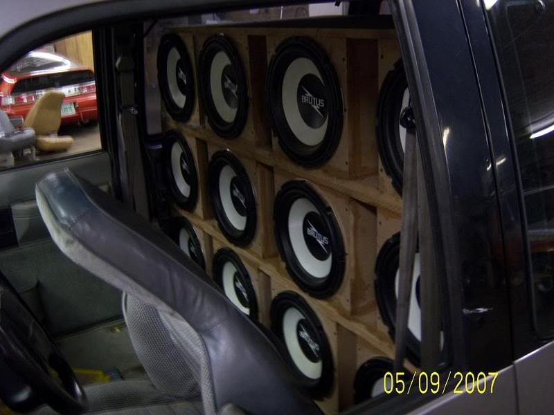

I did not install a relay, I actually thought about it. But what I did do, was run power off my dims, then I leave my brights on all the time, because the headlight I got is a dim only HID. So I only turn it on when its dark out. and I dont ride at night much. So the HID headlight rarely will get use. But I took it out last night and I just couldnt believe the difference, its bright than any car I have ever seen and I only have one bulb on!
And also, the Astro, I do stereo comps. The Astro is for something they call bass race, van houses 12. 12" woofers, took 2nd place in last years world finals. Here is a pic for ya....

Also the build is slightly different now, thats just pics of when we were fitting stuff in there and what not, so its different and way more tuned now. But it gets loud

Ah yeah I forgot you did the car stereo comps. I'm a old rusty veteran installer myself
Yeah not a bad idea for you to wire them up. Just be mindful that the ballast generates this ramp in current until the salts quite changing colors on warm-up, then it goes into low safe amperage. We see alot of guys burn up wiring, connectors, and MFS systems all from not using a relay. Simple addition to keep you safe

Its a taillight that has full LED's, half lights up amber when you turn your turn signal on. and has the white LEDs at the bottom pointing down for the liscence plate, I will get some pics and vids tonight hopefully. Its pretty sweet, I love it, and I love the clean look on the back, just sooo much I want to do to the hawk, just not enough time in the day! lol

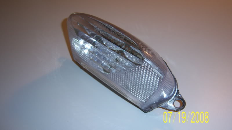

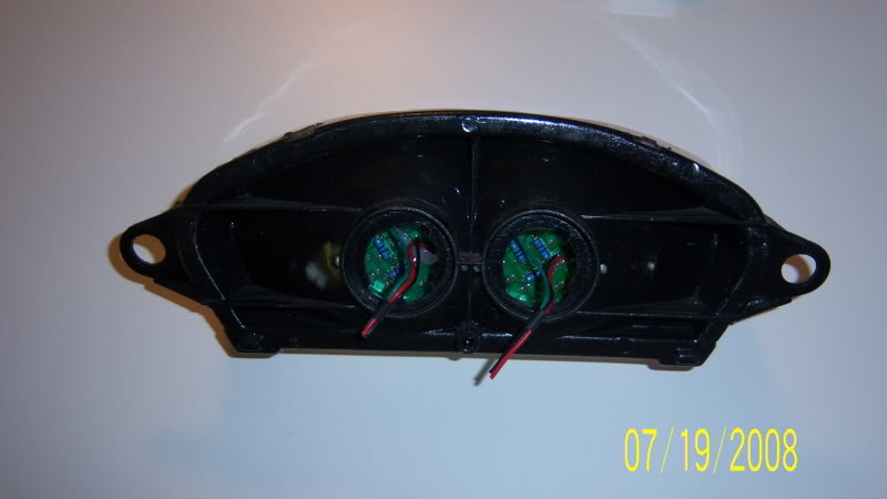

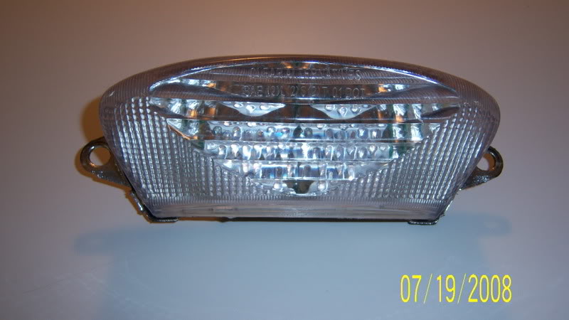

Pics of the taillight I took off, this was on the bike for maybe 3k miles max.

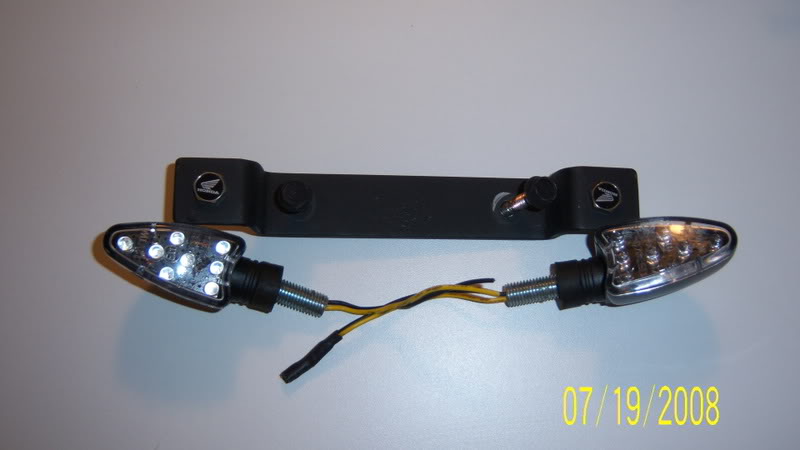

Also have the fender eliminator kit I took off.....

What are you asking for them? Those are front turnsignals? and integrated tail light and rear turns right?

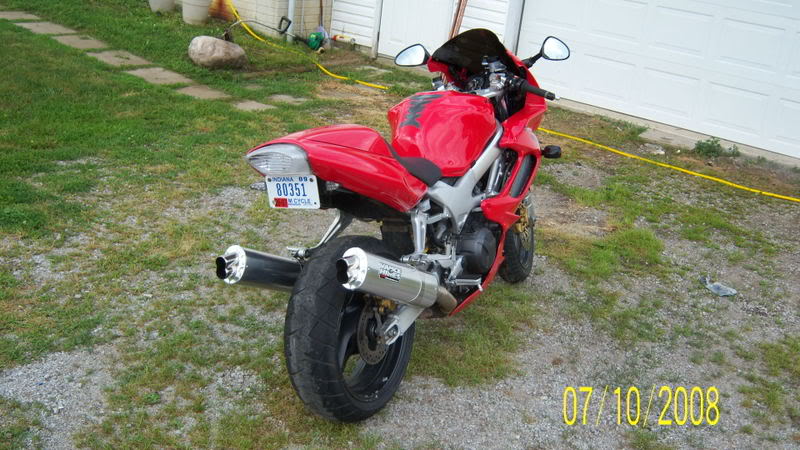

The taillight is red only and has the normal fuctions of stock, no turn signals built in. And the bottom pic is the rear fender eliminator I had, rear bracket for the liscence plate and rear turn signals. Here is a pic of it on my bike....

I am asking 45 shipped for the taillight. not sure on the turn signals and bracket yet, have not thought about it. Make me an offer though? Thanks!
