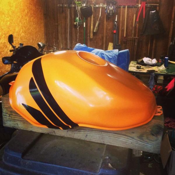

So in deciding to go with a repsol replica hawk, my first step was to get the tank the right color and get the wings for the tank. With the matched base and colorcoat from colorrite, and the wing from alloutgraphics.com, I think I came pretty close to nailing it. If anyone was wondering about these two companies, I would definitely recommend them. They ship quick and their products are outstanding. Will post a pic later.

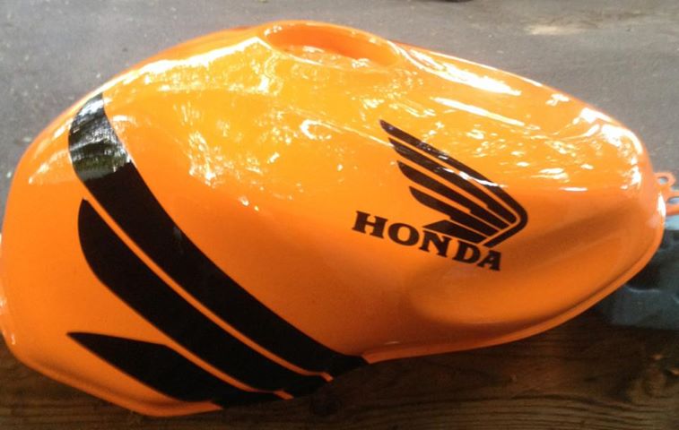

finished product!! So shiny without even buffing/polishing!

Originally Posted by jerryh
Who painted that? Beautiful.
I actually painted it myself. Ordered an 11oz rattlecan of base paint and repsol paint from colorrite and their kk7 clearcoat kit. The urethane rattlecans sprayed and covered well and evenly. The kk7 clearcoat kit is a urethane clearcoat with a catalyst you mix in and it comes with a sprayer to apply it. The clear was a little harder to work with as it seemed to go on kinda thick and then seemed to flow and spread after half a minute or so. So making sure your coats were even took a little more attention. The finish is absolutely gorgeous and is supposedly tough as nails.....only time will tell. I will definitely update as I go :-)

Yeah I hate rattlecans usually but I didn't want to cough up over 60$ for a pint in a can. The 11oz spray cans were enough to do 3 coats of base with a light 1000 grit sand in between and 3 full even coats of color with no sanding between coats. The 6oz clear was enough to do 3 full layers of clear as well. This was the first time I've cleared over graphics too, and I'm so glad I did, the sheen is so nice and even. I'm so glad I didn't cheap out on the paint. True story, you get what you pay for.
