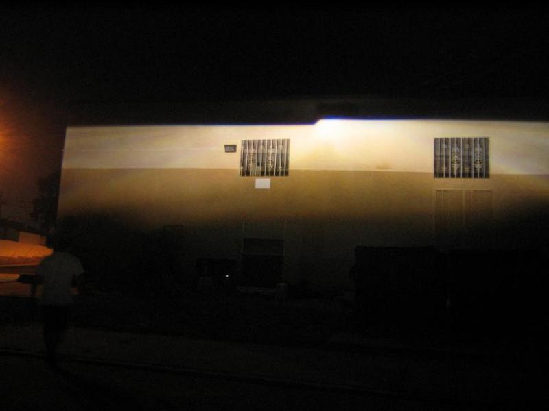

If anyone is going to upgrade their lights please use a projector. They were designed to focus the light of the output in a specific pattern. Just last night I was having to explain to my wife the reason we were being blinding by an oncoming car is because the dumb *** bought a drop in kit and put it in his car so he could see better. Of course this driver has no respect for others on the road and in fact is going to possibly cause an accident.
As you can see from this pic from Anto's HID retrofit the cutoff is extremely clean. It has a notch in the middle and is slanted lower on the left just for the purpose of not blinding oncoming cars.
So one of these kits will be fine as long as you use a projector with it. If you get a Bi-Xenon projector then you have a nice cutoff and you still have highbeams. The projectors actually have a plate that covers up half the beam then when you switch your high beams on a solenoid lifts the plate up to allow all the light to be projected.
Not to thread jack but my thread here shows my retrofit I did but it has comparison pictures of another bike that is using an after market non HID bulb. I think there is a link in that thread to most the parts i used to do the same.

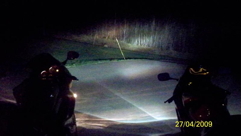

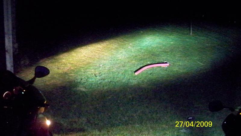

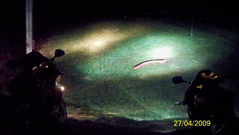

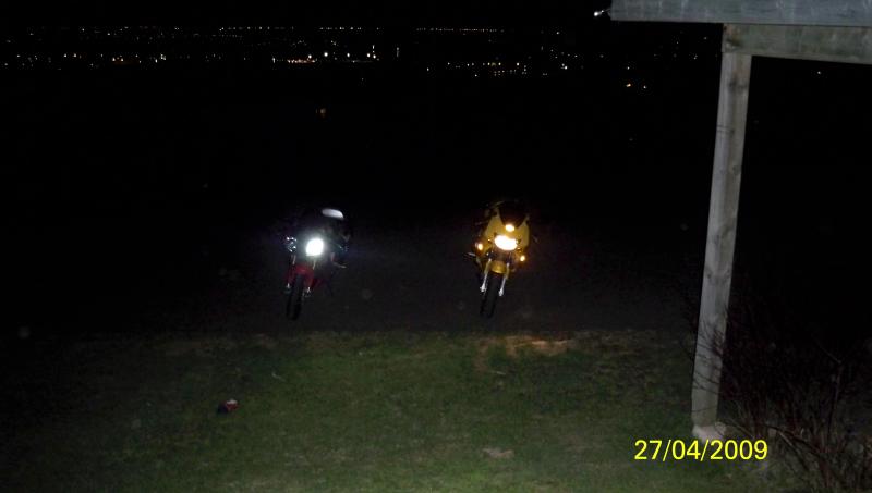

Old Apr 27, 2009 | 05:37 PM
finepooch's Avatar
Posts: 1,269
From: moncton nb canada
my rc51 kit was a drop in and i'd say it's beam pattern is satisfactory. i did not repoint the lights either. here are some pics along side my hawk.
maybe i'm a dumbass? hahahahaha, just kidding!
