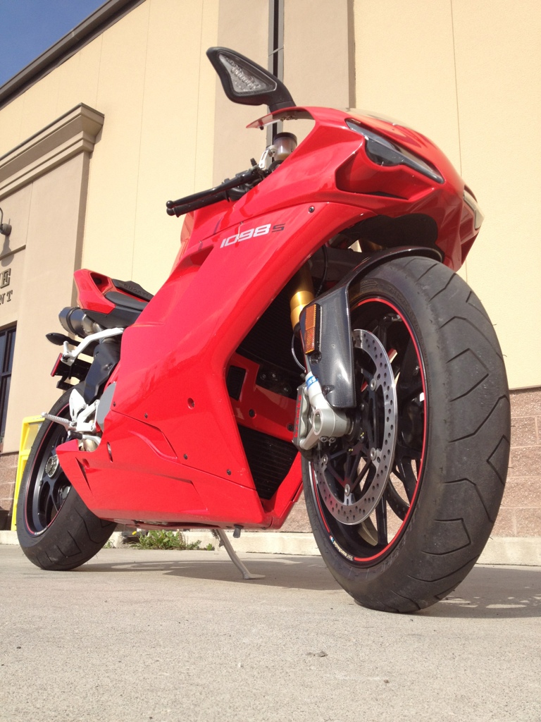

Incidentally, I have managed to add another bike to the stable in the meantime--one of my longtime loves. Got a great deal on this 1098S with only 400 miles on it!!!
The VTR is still lighter, though...but not faster
