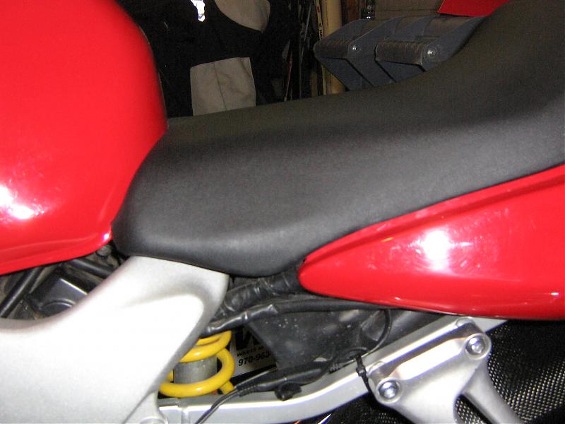

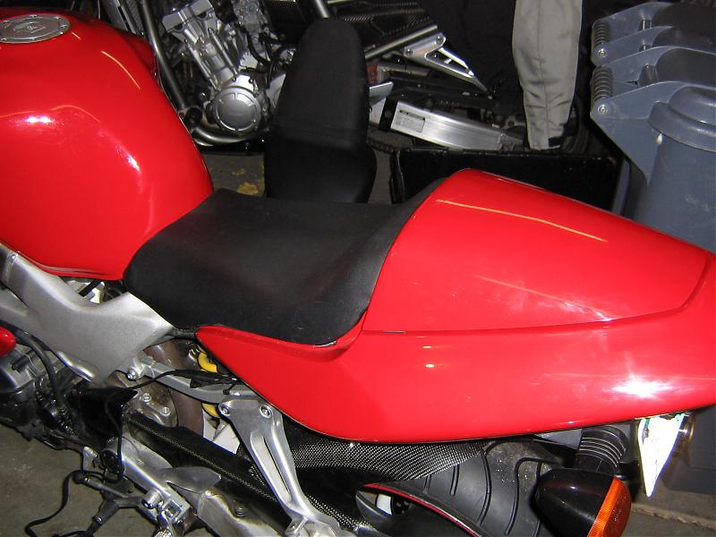

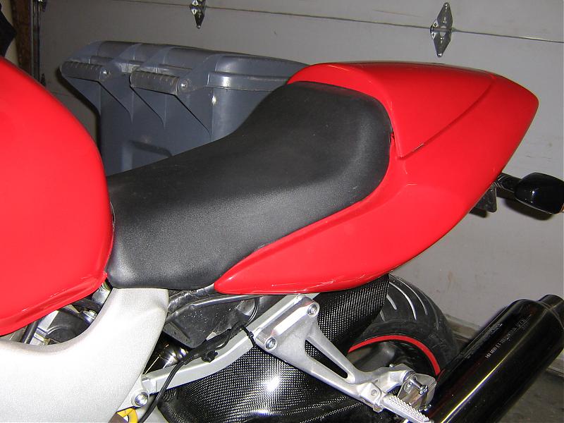

Old Jan 17, 2008 | 05:43 PM
joe6pack's Avatar
Posts: 71
From: Glenwood Springs, CO
joe6pack is on a distinguished road
Spenser seat pics
You would need to look at it next to a stock set to even tell it had been modified. Highly recommend.
Attached Thumbnails custom seat alternatives-img_0304.jpg   custom seat alternatives-img_0298.jpg   custom seat alternatives-img_0302.jpg   custom seat alternatives-img_0301.jpg   custom seat alternatives-img_0300.jpg
