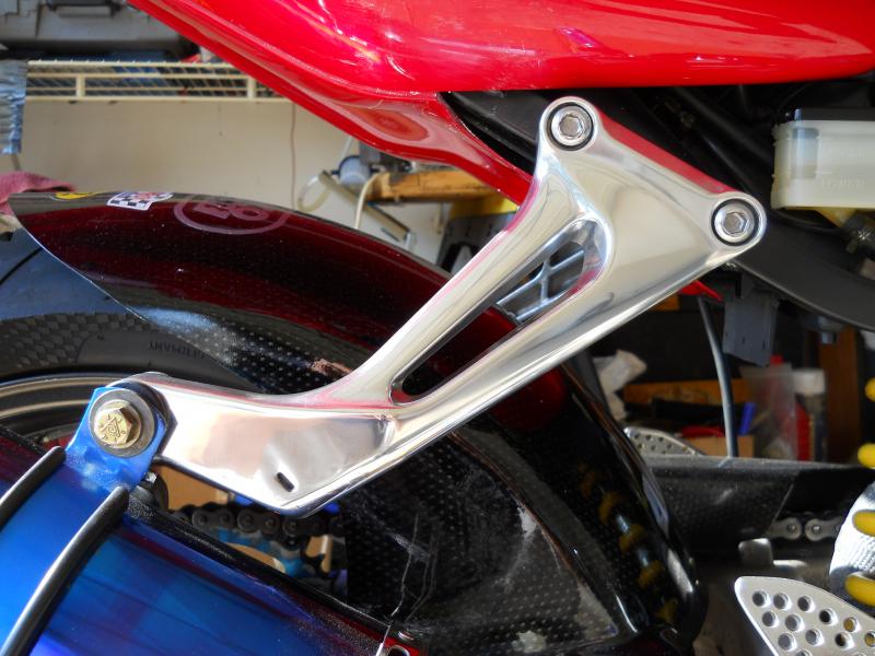

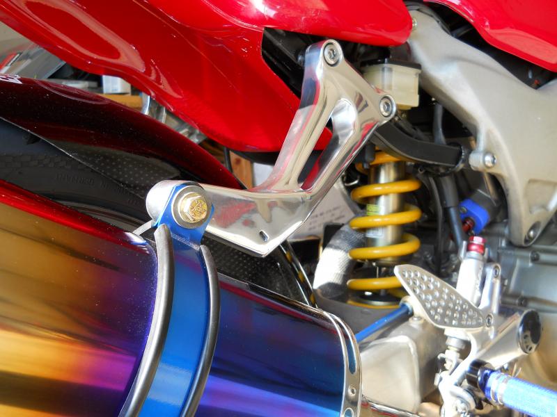

Yes, location for the resevoir is important, concur must be kept below the radiator cap, or overflow of the radiator. Having worked on many different engine applications as a generator tech, have witnessed what can go wrong with this issue.
One possiblity I see, would be behind the rear shock, in between the rear wheel. Not sure you'd be able to use the stock resevoir though. Would take some closer examination. Maybe a round tank, with proper fittings. Just keep in mind, that you need clearance when swingarm fully compressed.
If the little mud flap is removed, could be uses as a possible mounting tab.
Just my 2 cents worth. Picture maybe shows area.

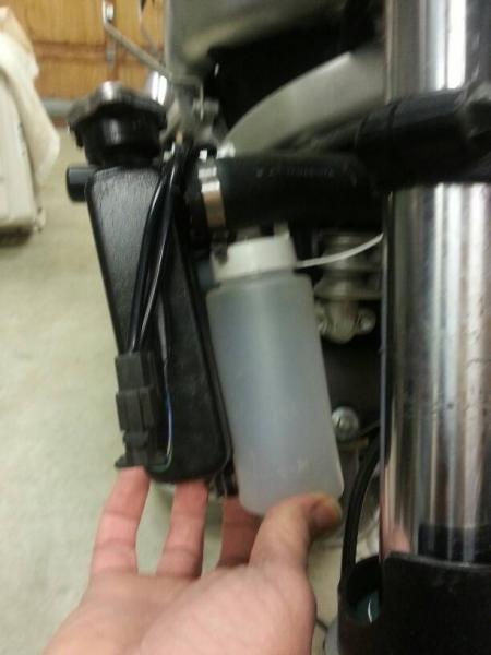

I was looking for a 8oz plastic bottle that had 1oz graduations, but take a look at the following pic and let me know what you think.
It seems obvious, but how about right in front of the fan on the left radiator, just behind the filler cap?
Shown is what I believe to be a 6oz container.
You could use what is now the overflow tube that feeds the current location tied into the existing vent tube. Then route a new overflow tube to the bottom of the container, onto a nipple epoxied off the bottom of the bottle.
Not sure about fairing clearance though.....
