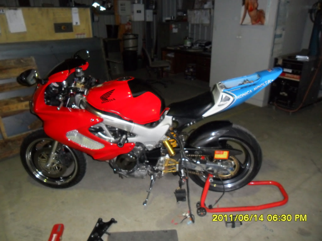

I know its been done ,but this is my version of the cbr 1000rr tail on a hawk
Tried it straight on ,way too long

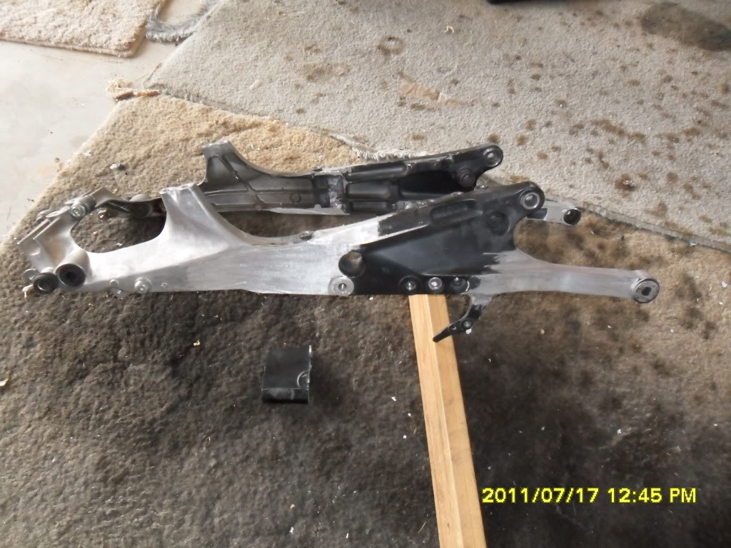

So cut 55mm from centre of subframe,and extended the btm rail to mate it up to the hawk frame.

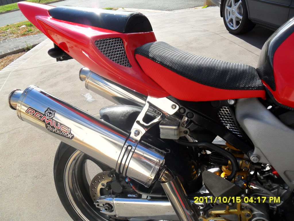

This caused a problem with the cbr undertray,would not fit.
so fabricated one out of alloy,and also a battery box

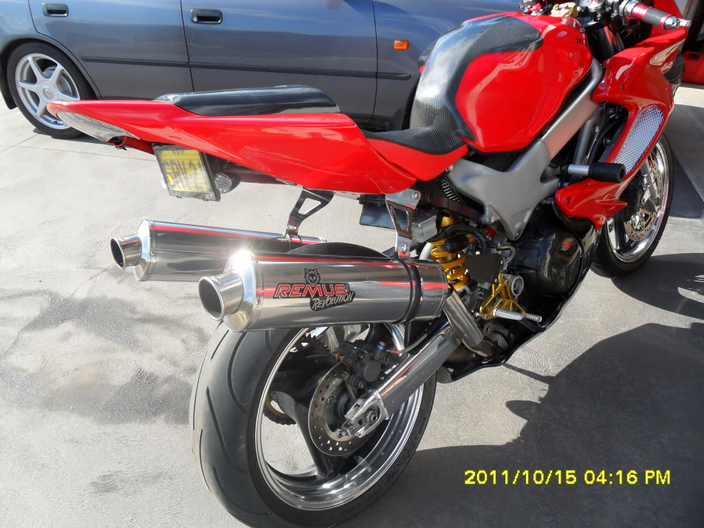

Made up some exhaust hangers
Then the fun bit trying to fit the electrics under the seat

My hawk before
And after

The subframe looks like cast aluminum, is that hard to Tig and keep structural?

Nicely done very professional looking!
Thanks
Is aluminium,all we did was cut it and Tigged it,and no need to brace
Have had no probs with cracks in frame yet
