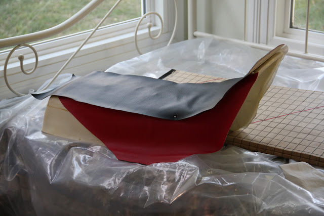

Making a seat cover at my friends house

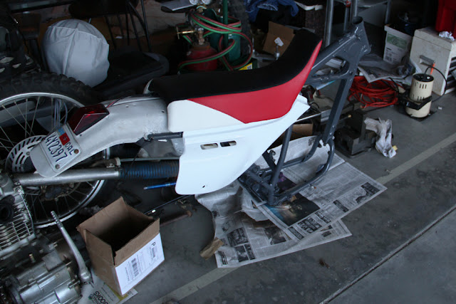

Old seat, new Gutz foam (taller, harder)
Repainted the frame battleship grey, need some new plastics and stuff
